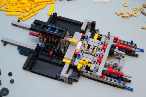

Can anyone explain why is there second 8 tooth gear near knobs? It is not connected to anything.
To generate more friction/resistance I suppose. I have seen this technique used in other sets as well.
From what I can see, the new axle connectors have no ridges to hold the drive ring in place, so it relies on the gear change lever to keep it from popping out of gear. Maybe the extra friction is there to prevent the cranks turning enabling the car to pop out of gear.
Not quite. The axle connector was modified, but so was the new driving ring. As such, the latter cannot slide freely on the new axle holder but only assume 3 discrete positions. For everyone else's benefit, we're talking about old/new axle connectors + driving gears, as pictured below.
18948.jpg +18947.jpg?1vs.6538b.jpg + 6539.gif?0
Edited by DrJB
Not quite :wink: . The Porsche has even newer axle connectors without ridges to make peddle shifting more smooth (snapshot from official video):
