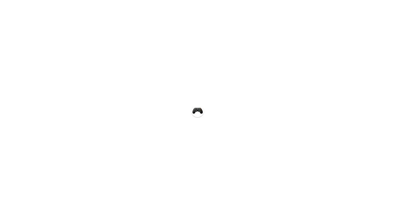

Hi, i recently bought a google chromebook from google and installed brickcontroller 2, downloading and installing worked smoothly but the application wouldn't open, it'd stuck on a blank screen with a controller icon in the middle then crashes immediately. Are there anyways to fix this?
Hmm, to be honest I've never tried BC2 on Chromebook so I have no idea if it's compatible with that. Is that Intel based though?
On 7/8/2020 at 1:03 AM, Newest_Tech320 said:
Yes, it's got an dual core intel i5.
