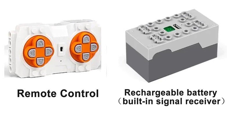

imurvai Posted August 18, 2024 Author Posted August 18, 2024 On 5/30/2024 at 4:09 PM, DI1 said: Is there any possible way to run this on a raspberry pi? Good question, I don't have any experience with PI so far. On 8/1/2024 at 5:50 PM, antondecock said: Hi, i recently bought a moc on aliexpress, and it had 3 controlling units of the mark “xp block” in it. The units are similar to buwizz 2.0 bricks, but the app control has much fewer options as brickcontroller2. I tried to couple de bricks to the brickcontroller app, bit it is not compatible. I was wondering if it is possible to make brickcontroller2 compatible the xp block so i can operate the moc with a controller. Sorry, I don't have suck a unit and without that I can't support for it. But if someone implement it I can merge their changes into the app. Quote
