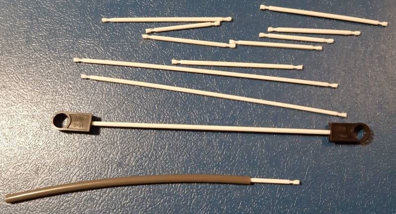

I'm working on a MOC right now where flex system parts could be invaluable, but while I have a handful of the ends, I only have two cables, so I decided to try @syclone's idea and make flex system cables out of 3D printer filament. I'm using 1.75mm black PLA filament, which is a perfect size. My .1mm resolution digital calipers can't tell the difference between the original and the filament, and neither can I in practice. The only tricky part was cutting the notches. Originally I tried a fancy solution involving a drill and Dremel tool (as I realize someone suggested on here, as I reread it), but I had no success. In the end, I just took my small, sharp Swiss Army Knife and started carving away, going around the diameter, and was surprised to find it worked great! I've just made an 8L one so far for testing, but it seems like it should be easy and dirt cheap to make ones of any length I need now! (Well, apparently 335 meters is about the limit of a single 1kg spool, but I can't see applications for anything that long!). Since I already have plenty of filament, it costs me about nothing, but if any of you who aren't into 3D printing are interested in trying to make some yourself, you can get really tiny spools (designed for 3D pens) dirt cheap, like this $2 one here: https://www.amazon.com/Basage-Filament-Temperature-Printing-Supplies/dp/B085Y61WKJ/ref=sr_1_2?crid=1A0X42Y0WY8TD&keywords=1.75+pla+filament&qid=1662516001&sprefix=1.75%2Caps%2C170&sr=8-2

Good work. It never occurred to me to try raw filament, as I'd assumed that the diameter was too large to fit the sleeve, and had never got round to measuring.
I guess we just need a reliable way to notch the ends... (goes off to design a tiny mould to squish a warmed filament end into... 😉)
Huh, that's a thought! My first plan was to design a jig to reliably notch it with the Dremel tool, but it didn't seem to work great for me. It would be nice to come up with a reliable, automated way to do it.
