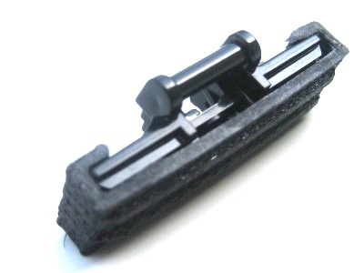

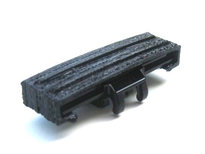

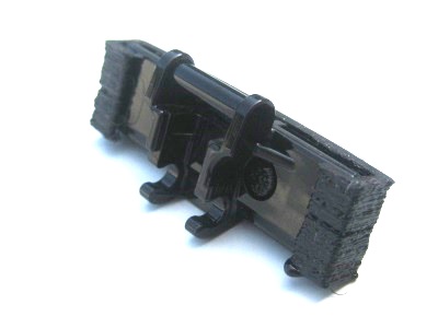

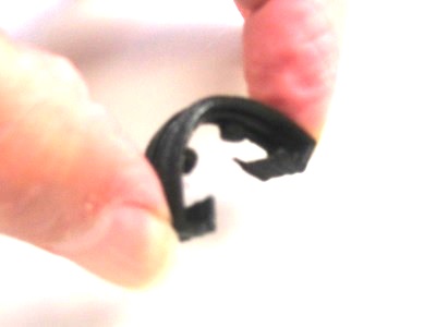

  • Author
I have printed my first track shoe. Here is the result.
I'm not really satisfied because the PolyFlex is quite slippery and has not the effectiveness of the window joint.
The weight is 1.5 g. I'll try to make it thinnest.
Edited by oracid
I think the tread will have issues because of how it overlaps the edge,that will limit the type of suspension you can use. Also maybe change the tread profile for better grip. Maybe try using Ninjaflex as a rubber material.
Edited by Tommy Styrvoky
  • Author
I have already ordered NinjaFlex. I am waiting for it.
The PolyFlex will be useful for making flexible beams, shame he's black.
For the overlaps of the edge I think I understand what you mean but can you be more specific. I can reduce the recovery but not much.
Have you a better idea?
