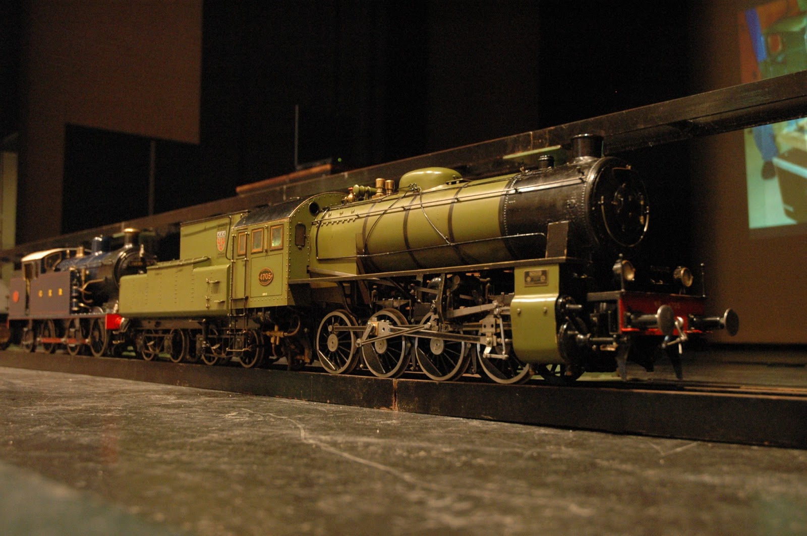

I want to build a Dutch steam engine some day. One of the prototypes that came to mind is the NS 4700 class, which was bought directly from Nohab during WW2. Problem so far is the colour scheme since there are not many parts available in Dark Green. The ducts for example were dark green, but those aren't available (yet).
Thanks a lot, Rijkjavik and Steph 104th !
I’m not quite sure what you mean by „ducts“. To judge from these pictures, it seems to me that it should be possible to model with LEGO, perhaps even in "normal" green?
Or, as the NS class 4700 was actually a clone of the Swedish M3b, I suggest you build it in black and blue… :wink:
