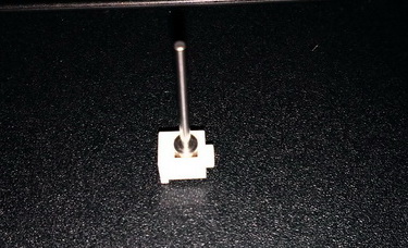

I have some mechanical background, and was thinking to use a 5mm HSS reamer to enlarge the Technic hole. @coaster :wink:
see picture: HSS reamer for those who don't know what it is.
It's not cheap, I can use one from my company. :wink:
