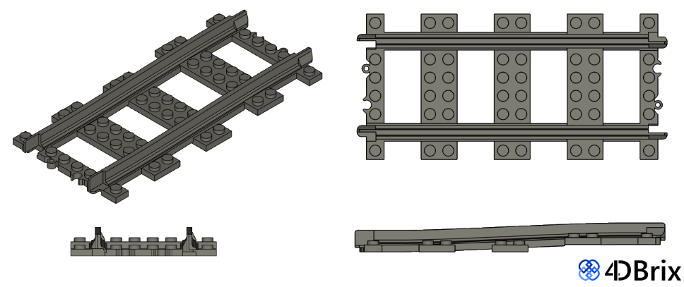

I was wondering, would it be possible (financially/design) to make (double) straights that have a height increase? So 1 plate/straight higher at one end and the sleepers adapted so they are level (if you understand how I mean)

Small 'ramps' to overcome a 1 or 2 plate height difference is one of the things we thought about for our extended range of 3D printed track segments.  This is a track we designed a while ago but we haven't tried printing them.  It's a 16 stud long straight track that raises the height by one plate (3.2mm).  Is this what you're looking for ?  If so, I can make a print in dark bluish gray and post a picture...

Hi all,
If i look to the right bottom picture, I have the idea that you will end up with a bumpy track, and no smooth increase of height if several placed one after the other. Or is it an optical illusion?

No, it's not an optical illusion.  This track is designed to overcome a difference in height of 1 plate, both ends of the track segment are horizontal so you can connect it to standard PF track.  So if you connect them you will indeed have a 'bumpy' track.  If you want to create a steady slope you need a set of tracks, like for the LEGO monorail:
  • a lower ramp: starts off horizontally and then gradually increases the slope
  • an upper ramp: starts with a slope that gradually decreases to a horizontal track
  • ramp: has a steady slope and is used in between the lower and upper ramp
It's feasible to make that, but I guess you would want to do that with a slope that is steeper than 1 plate / 16 stud segment...

I know that the recommended max slope is 1 plate per straight so you have a 2.5% incline. I think that producing a set of straights that have sloped rails but perpendicular sleepers would be ideal. then you need a slope start and a slope end and how ever many in between to over come the obstacle.
Another option that I have employed is to slant the baseplates the track is attached to, then it is linear all the way up the incline

Indeed, a system with a start/slope/stop configuration would be the most flexible system.  I'm just not sure about the 1 plate per straight slope.
What applications are you thinking about ?  To me, one of the more obvious applications would be to make a bridge.  If you want a train to be able to pass under it you need a least a clearance of 12 bricks.  With a 1 plate per straight slope that give: 12 bricks = 36 plates => 36 x 16 studs = 4.6 m or 15ft, on one side so you're talking about 9m / 30 ft for the complete bridge.  I would think that's too long for most situations, no ?  Another issue would be price, 3D printing sloped track would not be cheap: a) you would need to print with a low layer thickness (more layers to print) to improve the approximation of the lope with print layers and b) you need to print more support material than for a 'flat' track segment.  So the lower the slope the pricier the system becomes.
