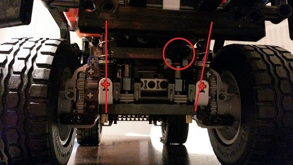

Hello people, after some inspiration and enough enough spare time i have made some improvements to the new front axle, i was able to test it in real life and it was surprisingly strong, and despite i didn't have a Servo motor to test it, i have faith that using a Servo will make it work perfectly, and here it is:
I made some pretty weird drive system, despite is not enough realistic as the one used in Unimogs, at least it looks similar at first sight, and most importantly, it works, it has a gear reduction of 9:1, the portal gears can be changed from 8/24 to 16/16 (with some small rubbing), the small wheels placed in the steering pivot are used to avoid the movement of the tires, because they are held only by a 5L axle and sometimes that's is not enough robust with weight, they can also be removed if needed, but i use them to get a more realistic look without the tires tilting in, they could be changed depending of the width of the tires used:
Next we have the steering, nothing very complex, it could be said that this system may force some parts because the steering rack and the parts connected to it are compressed against the axle while turning, but since the displacement is not enormous, the flexibility of the parts allows this without problems, a reinforcing bar in the front is used to make the steering a little bit more robust a Servo motor is used to power the steering system directly:
And here are the different systems arrangement, including the diff-lock (the same as previous versions):
