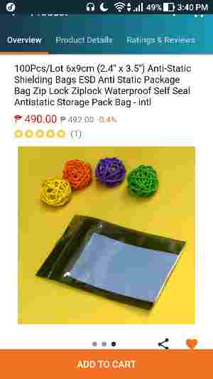

Hi i was able to find this Anti Static Shielding Bags, composed of APET/ CPP (Amorphous Polyethylene Terephthalate/ Cast polypropylene)  will this be ok? For long term storage? It has polypropylene which is good,but i don't know about polyethylene Terephthalate.. Hoping for the reply guys thanks in advance
Edited by emramada
I don't know.  I've read the LDPE was good, and it turns out that's what I'd been buying (I did intentionally get thicker than "sandwich bag" plastic).
