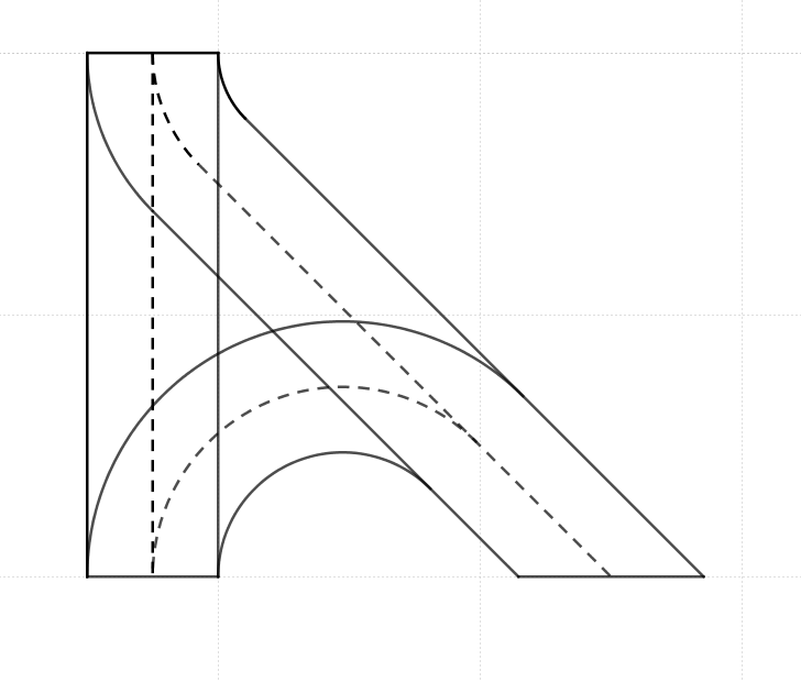

Posted November 3, 20168 yr I've been looking at Mike Gallagher's SNOT roads, in particular this one because it joins two roads at a ~45 degree angle: http://gallaghersart.com/gallery/view/category/roads However, as you can see in the image I made below, it is not *exactly* 45 degrees. Has anyone come up with a working method of joining SNOT roads at regular angles? Thanks. Edited January 18, 20187 yr by Dilvish
November 3, 20168 yr You will always need to approximate it I guess. LEGO is very much 90-degrees oriented so making this is already amazing ;)
November 3, 20168 yr Author Never mind, guys. I was able to get an *exact* 45 degrees using the following step pattern. :) [edit] I made some more progress: They all align to either 32 or 64 stud widths. [edit] This is my next goal: Edited November 3, 20168 yr by Dilvish
November 3, 20168 yr couldn't you flip the studs the other way on your 45° road (and switch to regular slopes instead of inverted) and fill in those gaps with #92946 "Slope 45 2 x 1 with 2/3 Cutout"?
November 4, 20168 yr Author They do flip to either side of the yellow center line. Which is why I can't use the smaller slope. Download: http://www.mediafire.com/file/qgt1zrq8v514t93/ldr_diagonal_snot_roads_20161104.zip Edited November 4, 20168 yr by Dilvish

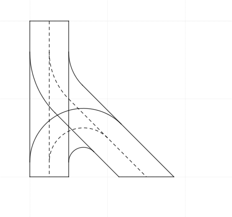

December 15, 20177 yr Author Some updated designs done in GeoGebra. I have not tried to model them in MLCAD yet. http://www.mediafire.com/file/0m7e4sd8s9oe865/ldr_diagonal_snot_roads_20171215.zip Each grid cell is 2x2 baseplates wide. Edited December 15, 20177 yr by Dilvish
