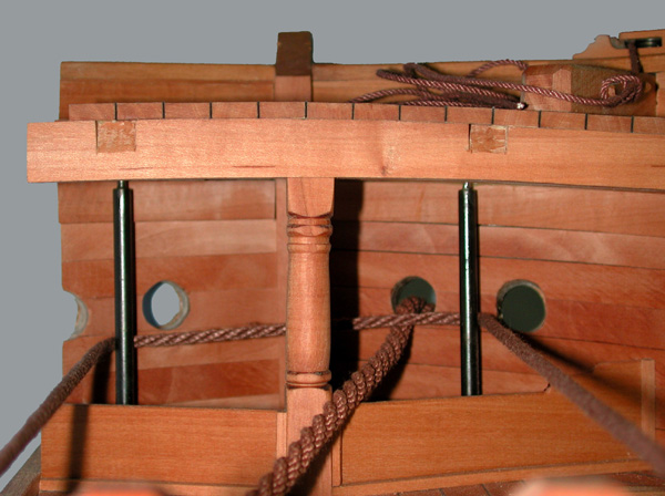

During the 'Age of Sail' ships (we commonly use as a base of reference for our Lego models) didn't have an anchor chain, they had an anchor rope. (Maybe some knowledgeable EB member knows when the change occurred?)
The anchor rope it self didn't go round the capstan to lift the anchor, it is too thick.
The capstan has a so called messenger rope, and endless loop, going around rollers in the manger (place to clean the dirt of the hauled in anchor rope and let the water drain away, not to store livestock)  the anchor rope was secured to this messenger rope by a small pieces of line.
On even bigger ships  (three masted) the capstan dedicated to lifting the anchor was even behind the main mast (where it also worked on the big yards) so the messenger rope ran all the way trough the ship (around the masts) giving it a long length and lots of pieces of line to transfer the weight from the anchor and rope to the messenger rope to the capstan.
Dedicated crew members (maybe the powder boys?) where in charge of connecting, and loosening the small pieces before the reached the capstan, the anchor rope was stored in the hold midships on racks so it could dry.
Seen in the picture, the hawse holes, with one anchor rope (thick) coming in, the manger(boards) the rollers and the messenger rope.
http://i.imgur.com/csa1vgp.jpg
http://i.imgur.com/at1HDUL.jpg?1
https://imgur.com/jPdPYOx
Here some links to some ship deck plans, where you can see the location. (you can find more on google, searching for something like 'Frigate deck plan"/"age of sail ship deck plan"/ "ship of the line" etc etc)
Hope that helps, enjoy your build.
