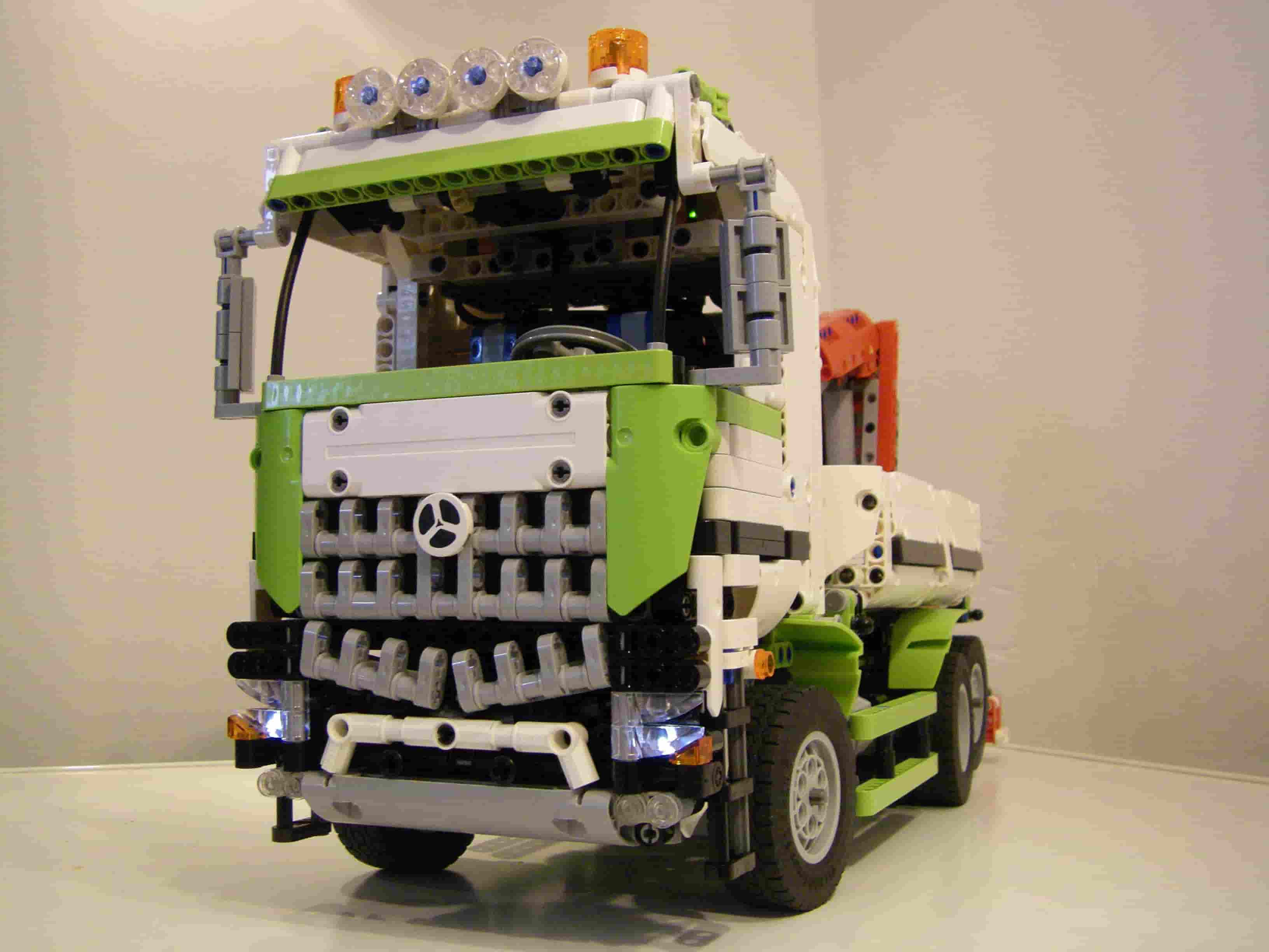

Posted November 15, 20168 yr Hi there, some of you might like my recent project: By the 42043, Arocs seemed to be a MUST in Lego Technic. Since i criticize a lot of things in the buyable 42043 (too high; stabilizers at the wrong place and not fully motorized...), I decided to build a Thing I consider to be... maybe not better, but different. There are no pneumatics involved; everything is done by machanics and linear actuators. The Arocs-front is differently styled than the 42043. Motorized functions in "driving mode": - Steering (M motor #1); the steering whel in the cabin moves when the truck is steered - Driving (XL motor); the two beacons on the cabin and the beacon on the rear bumper are turning when driving; there is a front PTO for further attachments) - Lifting of rear axle (M Motor #2) (it steers while being dropped; it's locked while being lifted) Motorized functions in "crane mode": - turning of crane (M motor #1) - Elevation of crane boom (XL motor) - Bending of crane boom (M Motor #2) Motorized functions in both modes: - front lights - Stabilizers (at first, they are pushed out; after that, they are lowered (controlled by rubber bands) (M motor #3); the stabilizers' drive is connected to control three driving rings (red) in the center of the truck that change between "driving mode" and "crane mode" (I adopted Pipasseyoyo's principle from his "Recovery truck with crane") - extending crane is possible in both modes, but makes sense in "crane mode", exclusively (M motor #4) Manually controlled functions: - tilting of cabin (easy accessible battery box) - tilting of cargo bay (left or right) - cargo bay's sides can be opened (both left and right) - cabin doors can be opened - seat at the crane boom can be detached It took me 490 hours within 14 month to build it. The stabilizers were the first thing to be built; the other stuff was quite a long process with a lot of re-starts and improvements, espacially the crane, which has quite a bunch of precursors. To avoid malfunctions caused by mal-operations, every function is secured by white 24t gear which will slip in case of too high torque (or another construction with the same effect in case of boom extension), except for driving function. Now I'm very glad with it. After taking the photos, I re-designed the seat and the fake control elements at the crane boom, but I didn't take new photos for this marginal note. Brickshelf link: http://www.brickshelf.com/cgi-bin/gallery.cgi?f=566910 I appreciate your comments! Edited November 15, 20168 yr by Timewhatistime

November 30, 20168 yr I like it. It looks pretty nice. You did a pretty good job with the panelling for the cabin and such. I also really like the color scheme. The white and lime works very nicely together. I'd be curious to see more of the inner workings. I don't know if the model is still built up, but if so, maybe you can do a few pictures when disassembling in the future? Is it true that the outriggers have a dual motion with a single drive? It sure looks like so. This looks very ingenious. How did you do the raisable rear axle? How does the rear axle steer (if it does)? There are a few things I like less though. Mainly the fact that the middle axle is wider than the other two. Also, there seems to be no mechanism for raising the bed, right? Anyhow, really nice work overall, I like it :)

November 30, 20168 yr Author @ Erik Leppen: Thank you for your Feedback, both positive and negative. I do not plan do disassemble the model, so it is still built up. Yes, the outriggers have a dual Motion driven by just one motorized function: The outrigger is pushed out by the 13 L liftarms with teeth. At a certain point the second liftarm at the bottom will lock, so it cannot be pushed any further. But the 13 L liftarm with teeth is pushed a little more, so it causes the L-shaped liftarm (5x3) to sink down the "foot" of the outrigger. A rubber band makes the correct order: First step: Pushing out - Second step: sink down. The function of the rear axle (lifting/steering) I have described in the original post. The lifting is achieved by two 2 L liftarm (+0) which are turned by about 90° by a motorized function. When turning, they lift the rear axle for about one stud in height. The steering is achieved by a knob wheel which is linked by some levers to the steering function. The knob wheel turns about 45° degrees left or right, respectively. By that, it makes a pin (see picture) travel, which is mounted on a conventional steering mechanism (see pictures on brickshelf). The pin fits pretty well between two knobs of the knob wheel. When the rear axle is lifted, the pin lifts from the gap between two knobs. So the pin won' be travelling any more, when the knob wheel makes it's turn.

December 8, 20168 yr Author Once again @ Erik Leppen: You are right, there is no mechanism for raising the bed (see description above). You have to loosen the correct locks on the right side or on the left side, respectively. Than you can tilt the bed to the other side. There is a post that keeps the bed in tiltes Position (manually, as well). The middle axle is a Little bit wider, due to the double rims and due to the space I needed in implement all the mechanisms (espacially the liftin mechanism for the rear axle). I noticed the fact that is a little bit wider than the front axle and the rear axle - but I didn't mind as I realized that it corresponds to real trucks. They also often have an axle that is a little wider because of the double rims.
