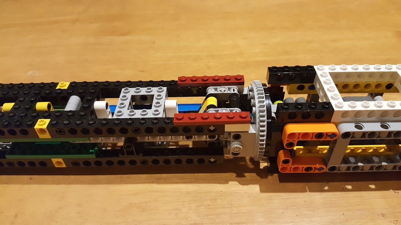

ok, continuing on from over on the EAS Schwarzkopf  thread about redesigning the rotating section...
Last nights prototyping session revealed some unforeseen issues with my original design. The rotating/floating outer frame that the decks of the rotating section connect too worked flawlessly as designed, but I'm not sure what the next phase of design for that section will require. In your design, @manglegrat, were the liftarms going through the centre necessary to connect the decks on each side of rotational axis? Highlighted here in red:
FYgmm_CrOhi96sV3hHio4u1W5cKksMsXyfRaPZvj
The centre structure was another story. My original design has a tendency to twist when turning each end, which loosens some of the axles/thin liftarm combinations and makes the internal structure increasingly unstable. I've redesigned it to incorporate t-shaped and h-shaped liftarms to prevent twisting. I've also come up with a design that I hope will work to attach each end to the frame of each section, although I have an idea on how to reinforce that connection. The lime coloured liftarm with perpendicular axle connectors could be replace with slightly longer 3L versions that have 2 pin holes. This fits inside and has more than adequate clearance during rotation.
twmaAdGOXnag3gJuPuWkjtFYQSB8NR18wRw-e2f0kZ3t5R8YXxndh5yAiRW1SQcYH2UlIWswiTR8kIDLD0f4IuwHMs7224fdOfeectBLp1jcR5zu9TGvTNsgl_LXA6KK27sKccUIN0NMpuymnGu4mXP98k2u7u3fTUfM1vB3wurwgbnrH9inMd847LViTcTqj8I6i-hkQHOVZIQU9HKpa6qYkojmDod2BqmoyQjMpJXFPtoV3W8aLlp0SWZaFmYiyPqpAOO-4Vb0j_wRS7AI0jlN0YD4PQnKyX5hGxfPbzn7c1w8DxIkFS9g4OWl8ifNL_CTZrIJVPDx8Ry5O4Xlw1Rp1kUfJv3v2VJECJbRFPcIHE0cOb6E0fOKrXVJ86YjkB-oyQ41UWsNpNksCp9mVYqxdO7Qq96lVdIT0rPS5wzmjlS9aJEEJwUj4065ttwjR_OI9Zblpy0rA-UX_0ZvhBxWXkwQAK4eN627sySPapzDc8ZgpF2Gz_vlpSlKGQNPHyfFE3Dj2JZozfRt5o6LN9IUiLV9B52gRnwgbpT6C6N6RAix8qfyDdjmGUV3tn14Yj76AtRX_7yZ1NCqmlMjD4iKlcQxxmfF1SR5s8BenwUZfRdkDii0518AMOSF1cOjaklVokrLP3lOk_03gSjKCO07Ymneu3PWXZw=w860-h477-noqb1GOUXY4TPaA-JAlK6mgETpQVtRcJbPyNmAto-uzldv-tsx0JKfm-DWBsMFJBOGTA3Wr8gC3o1jqc5NjR0-2ezJvjHl_ZGFNCTiLWo5eMHJPkFxZQPQhMJfNqL9P3326Q-CM7u21OgcQyV-5PCnmRZKiaMbUKGZh_p81Z8Xzlr5kdMaIroWaTcWIyMrM94pvr7mWKtvz3XgoYcMDI2p0P-qssIfhLzq4A-H-6AfQf8T0HZk1Z3Ba7Bn6n9fE5Afg9DhkAgrUdvdX48FK8ma3q21h5-xV__I2APYnq6Qi0pxpQfHq2HniichtbdYufI5DOhE6CMARQbHIACWhFfsh7Wv3PL5BNROi80G3JsR3eo7y5njhdxepYLRQdb78hCyjezTEUG_btir0mCrjCAzpqoT_rx589OleJstkeT7IzHHeWdZMoNIlqxiTB4SV6rSA2-V2IES07IW1HzSVf11meCtKiew6Gae6iGBGXg-5U_wq1B_iLqiIErLjo9YMjrt_V-M4Umnb2HIt86ep86CH_dqK8jtHkyeqraRo9I7dyTDQpjBmckRDK5KwQyow7N3ydHdW-OeVHWW4lob-8XXtoXEC07bxj21t3nT-f-d2w=w601-h533-no
If the red liftarms connecting the opposite sides of the rotating section are necessary, I'll have to redesign the outer cage to incorporate that function, most likely replacing the white liftarms in the picture above (right)

Good idea to continue here. :thumbup:
The first & third pics didn't come through again (and I noticed my 360 render from Google photos has broken in the first post as well, and I can't embed it again - :angry:), but your second pic with the bracing Hs & Ts looks great - good workaround, and I'm glad to hear it all rotates nicely!
I can't see the first pic but I know what you mean - I added them on a hunch, to provide some bracing through the centre to tie together the two "lobes" and help with balance/rotation/etc, not because I encountered a problem just using the clutch of the studs to hold the weight onto the outside of the frame.
They may be redundant, I dunno... I actually never tried it the other way! :grin:
Grrr... Google Photos and it's permissions for sharing images is a right pain in the big behind. Can see why many prefer Flickr.
