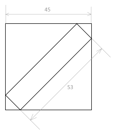

Milan Posted March 31, 2017 Posted March 31, 2017 Hi Aminnich, I can't take a very good look from photos, you need to measure it manually from two most distant points. Keep this in mind - Max 45L wide, deep and high or...max 45 in any direction. From the photo, it looks like you have taken some tiny advantage from diagonal line, ultimately leading to a bit bigger bot than 45L Take a look at this pic for Erik Leppen: This is not allowed. It may be bigger for just like half a stud, but we should keep all entries under or 45L. Quote
aminnich Posted March 31, 2017 Author Posted March 31, 2017 5 minutes ago, Milan said: This is not allowed. It may be bigger for just like half a stud, but we should keep all entries under or 45L. Was under the impression that it had to fit inside a 45Lx45L square in the starting position. Technically, my bot could be starting the match in the arena with the main weapon at a slight angle, but it fits. When I am building again later today, I will measure that green line you have marked and see what it is. Quote
Rennuh Posted March 31, 2017 Posted March 31, 2017 1 hour ago, Milan said: Hi Aminnich, I can't take a very good look from photos, you need to measure it manually from two most distant points. Keep this in mind - Max 45L wide, deep and high or...max 45 in any direction. From the photo, it looks like you have taken some tiny advantage from diagonal line, ultimately leading to a bit bigger bot than 45L I'm sorry if this is not the right place to ask this but why are there these two conflicting rules about the size? If I make a square bot of 45x45 it would be within the rules but also not because the diagonal would be longer? Quote
