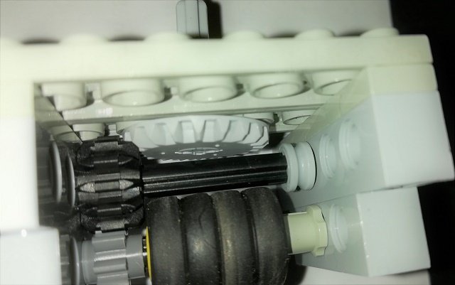

LegoMonorailFan: I trying to copying your design for the engine part that you posted back on page 2.
When i trying to turn it without the motor. it is very hard to turn.?
I suspect t that the rubberwheels hit the large vertical cogwheel or the above axle.
Edited by mrfuture
Here is a closeup picture of the gears .
having 2 more wheels is due to my design. I may reveal the the design later.
Edited by mrfuture
You have too much tyres on the axle. You have to use only 3 tyres. Second: replace the 6w cross axle above the tyres with a 2w peg/crossaxle connector (6562). Then it will work.
I personally recommend removing the two middle tyres, and shift the tyre on the left a little to bit to the right. The reason I shift the tyre is because sometimes it runs risk of rubbing up against the black bevel gear. Also as @FiliusRucilo has mentioned, using one of these in place of the 6 long cross axle that you've used for the black bevel gear is very important.
In the above photo, the space between the two tyres is probably 4/5ths the width of a technic bush. The tyre closest to the gears is ever so slightly closer to the other tyre to ensure that the tyre does not rub up the gears. The half bushing in back of the tyre is there to ensure the tyre doesn't move any closer to the other tyre while the monorail is running.
Edited by LegoMonorailFan
I thought of that but did not see anything that caused the problem. But have now removed one tire and put the black gear on a tan pin w/axle.
What i noted that everything was run fine until i put on the axle with the tires, I think it is the friction between axle with tire and the black gear.
What length of the axle on the motor ? 2L
Does the wheel axle have enough side-to-side free play that would allow the tyre closest to the gears to rub up against the black bevel gear?
The motor axle length on mine is 3L.
It could be that i try to turn it by hand on a short axle. But i think all works out when i place the motor on the top. the axles runs free.
