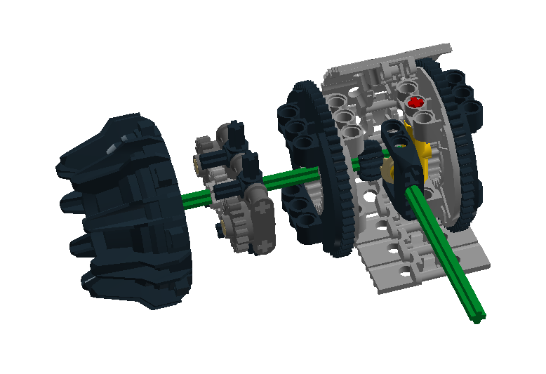

On 7. srpnja 2017. at 2:34 AM, cloud said:
I know that they can be separated, but I don't know how I would use them separated. In the photo above the turntables are used as hubs as well as driven wheel.
Do you have examples of how a separated turntable would be used?

  • Author
On 7/8/2017 at 5:38 PM, I_Igor said:
Hi Cloud,
I hope that this "pictorial" example will be of some use for you...
Interesting use, but I'm still not sure where the non-moving structure would connect and where the "wheel" or moving part would be. The gear in the middle of the grey half unfortunately has an axle hole in the middle not a pin hole.
In the diagram I added above, the green drive axle drives the black half of the turntable directly. Which is a mistake on my part in the drawing, but assuming it was ok, one can push the pieces together and the outer wheel almost touches the black half of  the turntable and the inner space between the turntables is two studs.
The mistake is that the planets in the gearset need to be anchored to the sun gear in the middle, not the ring gear(black half of the turntable).
It should be like this: planetary-ideal_zoom60.jpgWhere the carriage does not spin(an unused input into the planetary system).

  • Author
Here is the above idea I was talking about in ldd from the blog.
Note the pink half of the turntable will be removed.
Power comes in from the red axle. The blue carriage on the turntable side will spin based on the planetary gear set of the turntable. This will increase the final drive ratio of the ring wheel driving the track by counter rotating the carriage of the drive wheel gear set. Finally the paired drive wheel will continue to transfer power along the green drive axle and power a sprocket somewhere along the track.
It should be like this: Where the carriage does not spin(an unused input into the planetary system).
I think I have a solution for that, but haven't put it together yet because I'm waiting on the "ring gear" (wheel with inner gear) from a bricklink order. I'll try to put together an ldd sample of what I'm thinking about.
For carriage that does not spin you can use this
https://www.bricklink.com/v2/catalog/catalogitem.page?P=2711#T=C
And new beam 1 x 5 thin with axlehole at the ends to make beam 1 x 5 with axleholes at both ends and in the center :wink:
I was thinking that maybe the new bean could not hold the pins. I'll have to play with the idea and see where it goes, thanks.
