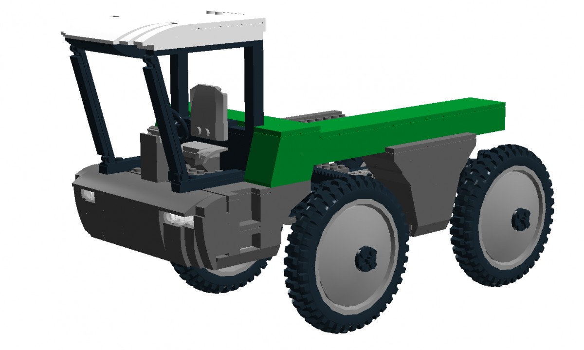

BrickbyBrickTechnic Posted July 19, 2017 Author Posted July 19, 2017 UPDATE TIME! So, I decided to start on the bodywork, because I have to ration the DBG arts in the set. Here's what I have so far: It's looking a little rough, so suggestions on how to make it better (especially the bumper) are wanted. Thanks for tuning in! BrickbyBrickTechnic Quote
1gor Posted July 19, 2017 Posted July 19, 2017 Hm, honestly development direction is correct, but I see steering selection at the back - perhaps it would be usefull to put it behind cab... Quote
BrickbyBrickTechnic Posted July 19, 2017 Author Posted July 19, 2017 53 minutes ago, I_Igor said: Hm, honestly development direction is correct, but I see steering selection at the back - perhaps it would be usefull to put it behind cab... Thanks! As of now I have removed the steering selection, so now there is just 4 wheel steering. There was no room behind the cab for the selection lever. Quote
eric trax Posted July 19, 2017 Posted July 19, 2017 (edited) I think you should reduce the width of the model by two studes. It would cover visually wide tires. Currently the sprayer is too wide Edited August 28, 2019 by eric trax Quote

BrickbyBrickTechnic Posted July 20, 2017 Author Posted July 20, 2017 (edited) UPDATE TIME! This is the second last update before completion, and it is tremendous. Several things have been added/edited: -Gearbox with shifter -Chassis made less wide as @eric trax suggested (effects only visible with wheels on) -near completion of bodywork There is one big problem: the model is very front-heavy with the battery box being on the front, so the model struggles to roll forward. HELP WANTED. Here are the pictures: (Sorry for the change of background, white background pics tomorrow) Rebuilt chassis. However, there is one problem depicted above: sometimes when steering, the black crossblock attached to the wheel mount hits the grey 1x3 crossblock, thus impairing the steering and making the vehicle skid. Any suggestions on how to fix that? More updates soon! The project is nearing completion. Thanks! BrickbyBirkcTechnic Edited July 20, 2017 by BrickbyBrickTechnic Quote
1gor Posted July 20, 2017 Posted July 20, 2017 Hi, first of all chassis looks good indeed. I would put battery box between rear wheels (make some kind of cavity so battery box wont stick out to much) to improve weight distribution. Yes, I'm (partially) working on sprayer (we have only one size of tractor wheels and with baloon tires something is missing as you can see in my Brickshelf folder if you are interested) from winter along with other models, but currently only my topic is Unimog U423. Curently sprayer is on wait because I plan to finish Unimog and drive / steering / suspension on sprayer is giving me some headachse due to limited parts, but after eye surgery recovery I'll work on sprayer - planing John Deere R4038 model to fit 1:17,5 scale of Arocs and Unimog. (Sorry for neverending post) Quote
mocbuild101 Posted July 20, 2017 Posted July 20, 2017 (edited) 1 hour ago, BrickbyBrickTechnic said: There is one big problem: the model is very front-heavy with the battery box being on the front, so the model struggles to roll forward. HELP WANTED. You could either move the battery box (possibly somewhere underneath, or if you are modelling the rest of it - on top), or increase the gearing down of the motor. Edited July 20, 2017 by mocbuild101 Quote
agrof Posted July 20, 2017 Posted July 20, 2017 This is a great idea for C-model, and You did very well to date. I really like the overall shape, and the cabin+front area. What will be the functions with the gearbox? If those will be not effected, than I suggest to put the BB on the top as part of the spraying tank: the tank would be built around the BB - just an idea. Quote
BrickbyBrickTechnic Posted July 20, 2017 Author Posted July 20, 2017 1 hour ago, agrof said: What will be the functions with the gearbox? If those will be not effected, than I suggest to put the BB on the top as part of the spraying tank: the tank would be built around the BB - just an idea. The functions will both be to deploy the sprayer arms. The BB is already placed where you suggest, but this does not balance the weight. Quote
TechnicRCRacer Posted July 20, 2017 Posted July 20, 2017 I can't see where the battery box is, but I would mount it directly behind the cabin horizontally if possible. Quote
BrickbyBrickTechnic Posted July 20, 2017 Author Posted July 20, 2017 3 hours ago, mocbuild101 said: possibly somewhere underneath, That will be my last resort: There is supposed to be lots of ground clearance. 1 hour ago, TechnicRCRacer said: I can't see where the battery box is, but I would mount it directly behind the cabin horizontally if possible. That's where it is right now. Let me post a picture to give some context. For all those wanting to help, first of all, thank you. Second, here's the current position of the BB which is causing problems: Quote
