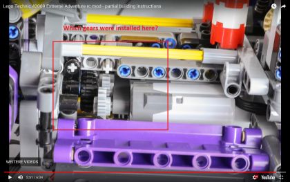

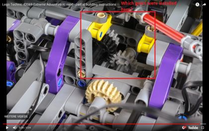

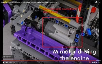

Joey73 Posted September 27, 2017 Posted September 27, 2017 (edited) @kbalage I have some Questions and need hints for some mounting Gears and an M-Motor for the Engine Simulation. See the Pictures below. It would be nice if you could help me here.In the video you can not see everything so precisely. How is the engine mounted here? How is it held How is it Held Which Gears were installed here? Which Gears are installed here? unfortunately I can only upload 100Kb to files Edited September 27, 2017 by Joey73 Quote

kbalage Posted September 28, 2017 Author Posted September 28, 2017 @tamahandy The buggy motors are driving the wheels directly from the outer (slower) output. Tested with the faster output as well but that was too much stress for the BuWizz units. I can help you with the construction of the axles, I created some photos while I was disassembling them, I can put together a small video similar to this one if it helps. It won't be a complete instruction set but might be enough to give you the idea. @Joey73 That M motor is mounted to an "L" shaped DBG liftarm with a single black pin, and also the axle is supporting it. Regarding the gears I cannot really tell you more than what you see on the image. As this model is disassembled I cannot give you more pictures. I suggest to try to fit the motor yourself in your build and see how these gears can fit and where/how you have to transfer the drive with them. @JTCN The buggy motors did not overheat, in some scenarions the protection of the BuWizz units kicked in when there was a sudden load increase (like hitting an obstacle or accelerating with full power from zero using the high output). To be honest I did not run these cars for too long in a single take, 2-3 mins maximum. Quote
