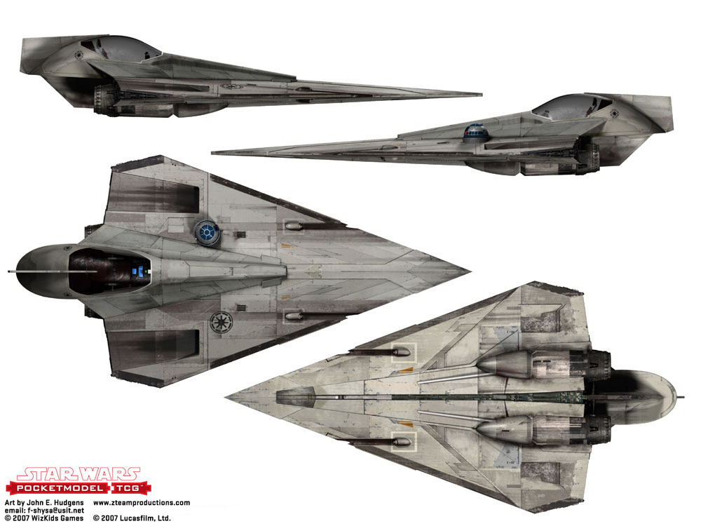

I did a quick "don't care about colour" prototype build yesterday, and have come up with a few improvements for internal mechanisms (especially around the upper hull in front of the cockpit), as well as testing and improving the rear dome of the cockpit and tail section. I've added a few wedge plates to improve the lines between the wing and hull and moved the rear wing mounts forward to better replicate the multiple curves of the rear section. This was the source image:
And what I've finally come up with...
