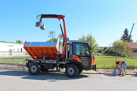

Anto Posted October 27, 2017 Author Posted October 27, 2017 On 26/10/2017 at 1:03 PM, Paul Klop said: How many attachments are you going to make? I don't know, I think 2 or 3. There will be probably a pneumatic crane, like that: But I don't if I can make something good without the new pneumatic cylinders (from the Mercedes Arocs) Then I'll also need to make something using the PTOs, which can be attached to the front or the rear. Quote
Paul Klop Posted October 28, 2017 Posted October 28, 2017 17 hours ago, Anto said: I don't know, I think 2 or 3. There will be probably a pneumatic crane, like that: But I don't if I can make something good without the new pneumatic cylinders (from the Mercedes Arocs) Then I'll also need to make something using the PTOs, which can be attached to the front or the rear. That normal mower (0:48 in the video) I think would be very cool! You can use the front PTO for the mower and you need to build some sort of tube (don't know exactly how ) connected to the container on the back. But you can also design something yourshelf Quote
