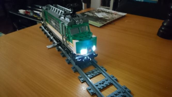

Yodah Posted August 15, 2018 Posted August 15, 2018 Here is my 60198 loco, retrofit to Power Functions, and with lights. The light modification makes the nose just a bit longer (two plates), which I think does not compromise the look (at least it will not once I'll have the correct parts in green) More pictures here: https://www.dropbox.com/sh/4cd0l0od2jpcy5o/AADo2-94SO8IPXv6OFwle31Aa?dl=0 Quote
