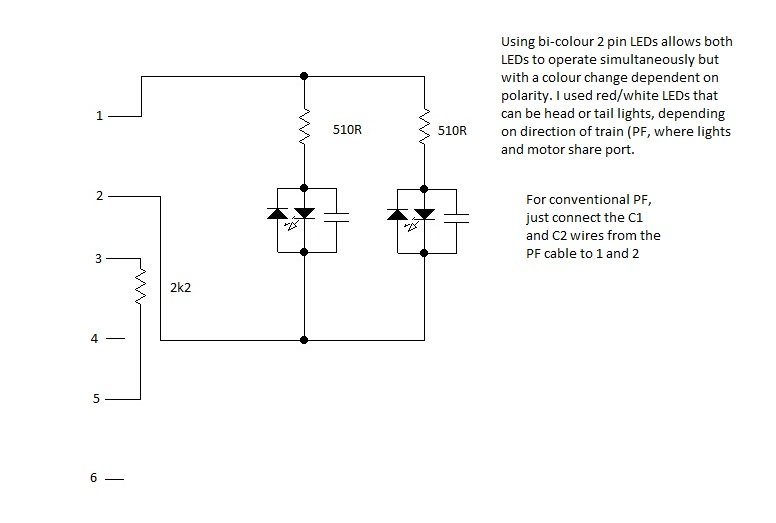

retrotecchie Posted August 21, 2018 Posted August 21, 2018 Try these circuits for signals or for reversible head/tail lights. Change resistor values to 4.7k for PF versions. For head/tail lights, a 3mm bicolour 2pin LED can be used. For signals, use a conventional red and green 3mm LED, but wire them with opposite polarities so with the direction set one way, the red LED illuminates and the other way, the green LED illuminates. Multiple signals can be parallel wired up to a limit of around 20 LEDs per output. The PWM frequency is around 10kHz, so you shouldn't see any noticeable flicker even only illuminating on each half cycle, so to speak. Quote

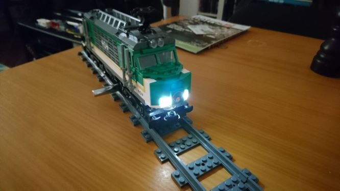

Carefree_Dude Posted August 22, 2018 Posted August 22, 2018 (edited) I've been working on adding lights to the cargo train, and so far have come up with this. The nose shape remains the same, but I feel I can do better http://i.imgur.com/ZmdcNPx.jpg Edited August 22, 2018 by Goldenmasamune Quote

Yodah Posted August 22, 2018 Posted August 22, 2018 2 hours ago, Goldenmasamune said: I've been working on adding lights to the cargo train, and so far have come up with this. The nose shape remains the same, but I feel I can do better http://i.imgur.com/ZmdcNPx.jpg That's a much better integration than mine for the shape factor, well done! How is the lighting direction with lights on? Don't the LEDs light up too much on the sides? Quote
Carefree_Dude Posted August 22, 2018 Posted August 22, 2018 8 hours ago, Yodah said: That's a much better integration than mine for the shape factor, well done! How is the lighting direction with lights on? Don't the LEDs light up too much on the sides? The lights seem to be mostly forward facing. I still want to find a way to hide the led pieces better and add the round tiles Quote
dr_spock Posted August 22, 2018 Posted August 22, 2018 17 minutes ago, Goldenmasamune said: The lights seem to be mostly forward facing. I still want to find a way to hide the led pieces better and add the round tiles There are 1L technic round cylinder pieces. Would that work? Quote
Carefree_Dude Posted August 22, 2018 Posted August 22, 2018 1 hour ago, dr_spock said: There are 1L technic round cylinder pieces. Would that work? I actually have one of those that i'm messing around with, but can't seem to get it to look right. (you can see a white one in one of my earlier pictures). The cylinder makes it stick out too far and it comes off too easily. I've also played around some with 1x2 bricks with the double holes in them but come across the same problem. Quote

Yodah Posted August 23, 2018 Posted August 23, 2018 13 hours ago, Goldenmasamune said: I actually have one of those that i'm messing around with, but can't seem to get it to look right. (you can see a white one in one of my earlier pictures). The cylinder makes it stick out too far and it comes off too easily. I've also played around some with 1x2 bricks with the double holes in them but come across the same problem. have you tried also the 1x1 round brick with open stud? not sure that they don't block too much of the light, but they might fit better in the LEDs. Worth trying I guess. 1 hour ago, waparesult said: Hello all, first time poster on here, but have been reading in the shadows for sometime Welcome! I had spent much time lurking from the shadows before my first post too (and still post only very occasionally), so congrats on taking this new step :) 1 hour ago, waparesult said: I appreciate not everyone will like my way of doing things so feel free to comment, but I chopped a 2/1 piece of the drivers cab roof out to be able to insert a 1x1 brick with hole and add the lights in so it looks part of the train, check out the youtube video below https://youtu.be/z1V0lBAfAkg I am one of the conservatives, don't want to chop pieces, but I admit that your render is very good ! It's a shame that the new PUP system doesn't allow more than one set of lights (except if you remove the motor) as you can't get both top and bottom lights at the same time without hacking cables. Other solution being to retrofit to the old PF system and be able to stack plugs... Quote

retrotecchie Posted August 23, 2018 Posted August 23, 2018 I'll hack if I have to (I took a Dremmel to a couple of PF straight track sections to make a crossover...) and that is a quite tidy solution for the upper lights on the Cargo train! Quote
