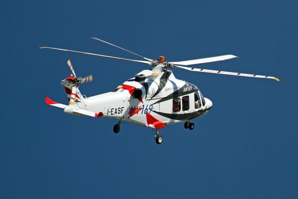

Hallo Steph,
the original AW 169 has 5 mainrotorblades and the backrotor is on starside, not on portside. What is the reason of your version?
Greetings
Udo
14 minutes ago, opaudo said:
Hallo Steph,
Greetings
Udo
Hello,
For the 5 blades rotor, it was just impossible to built it on the time it was designed. With the new parts available today it should be a great update. Unfortunately, the model is dimanteled actualy and i am already working on anather 5 blade helicopter. (and it is not TLG H175 :wink:)
For the tail rotor's position, the choice came out with the general setup of the flight commands. If you look at the instructions, you'll understand how tricky it was to fit the functionalities inside of it.
At one moment, i had to reverse the main rotor orientation (in order to get the collective controls in a logic setup). As it runs counterside of the real one, i prefer to pursuit the logic of my own built and locate the tail rotor on the logic side. This is the reason.
