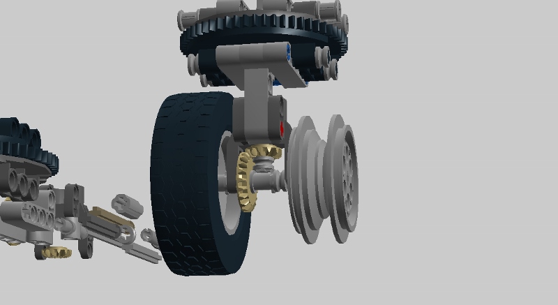

For my new MOC initial thoughts were to have a mechanical solution to control the steering using only one M motor and a selector gear box (see image)
Black = M motor input.
Red = output to caster units 1 & 2 with direct drive from M motor.
Yellow = output to caster units 3 & 4 via selector gear which can either turn units in same direction as 1 & 2 or in opposite direction, plus stop the units turning.
Result: selector unit too large and complicated and suffers from the excessive backlash due to the red gear clutches, about 90 deg. lag when reversing drive to units 3 & 4 resulting in caster units out of step.
REJECTED.
For the the previous build I used the small c/o switches on the PF controllers to set the steering modes but found this to be confusing to get right.
Reverting to a two motor solution for steering as per Mobile ship loading conveyor, except I will use PF switches this time to select the required mode for each M motor.
This will allow for 3 steering modes:
1/.    Normal steering using only 2 caster units with other set in straight position.
2/.    All caster units turn together same way for straight, crab & sideways movements.
3/.     Pairs of caster units turn in opposite directions to give radius steering.
A 4th function is possible if used an M motor for each uint plus four PF switches.
I but don’t plan to install this due space constraints.

Update:
Drive now installed and initially used a worm drive giving an overall reduction of 12:1 using  20:1 worm gear and & 20:12 step up gears which proved too slow.
Now changed to direct drive via 12/20 reductiongears.
Under carriage unit tested for drive and steering functions.
Steering: a new problem has appeared not identified in previous tests !!
Currently using two M motors to turn each pair of caster units.
The problem is the speed of each motor is sightly different causing units 1 & 2 to get out of sync. with units 3 & 4 especially if a lot of turns are performed !!!
So I may revert to a single motor for steering but dispense with trying to get mode 3 radial steering.
I.e. just have mode 2 for straight, crab & sideways motion with maybe a way to lock the caster units at each end for mode 1 steering.
Probably means reconfiguring the drive and steering shaft / gear paths..
Unless anyone has a fix for this problem.
PS I think this may have also been an unidentified problem with the Mobile Ship Loader Conveyor.

This is the drive path for steering (Green line) and drive to wheels (Red line)
L = drive motor / M = steering motor.
As it stands will only be able to steer the undercariage in straight - crab - sideways directions.
Looking for a way to disconnect aand lock a pair of caster units at either end so other pair of casters can turn independently for steering
The change over clutches have too much backlash, possible sliding gears mind work.
Anyone got ideas how this can be achieved ?

Hello, I´ve tested the clutch 2 reply before. I think it´s a fail inside:
It works better together with a differential :
38643034125_142c9d1fca_n.jpgIMG_20180106_173907 by Wolf Zipp, auf Flickr
Clutch left: left axle blocked
27762908639_984562d35b_n.jpgIMG_20180106_173943 by Wolf Zipp, auf Flickr
Clutch right: Diff blocked, both axles same turn
Clutch Center: Diff free, force on both axles, but maybe not same turns.
Force incoming to the diff or the right axle.
@Doug72
When you will drive a curve, you need a diff in the drive System, because every Corner get a other distance to drive.

I tried three differentials  before in drive train on my Mobile Ship Loader Conveyor but it failed.
See topic on page 2
If any wheel loses contact with the ground it starts spinning at full speed and ALL other wheels stop turning.
The under carriage is quite rigid, no easy way to give them independent suspension.
37617147104_0c1088c2bf_c.jpgIMG_5112 by Doug Ridgway, on Flickr
Probably ony workable solution would be MIndstorms EV3 with each caster unit powered and steered individually.
As it is now I am happy with steering for modes 1 & 2 and mode 3 if limit the degree of turn.

As you rightly pointed out when radial turning, the wheels on the larger outer radius have further to travel and hence have to run faster.
I think I have been ambitious in trying to have all powered / steered caster units.
With my current set up this does not seem achievable.
Going to try powering only one pair of casters at one end of under carriage with a single differential between sides, this along withe the differentials in the caster units should ensure all wheels rotate at correct speeds.
Just done a quick trial by disconnecting the drive to one pair caster units with a tempoaray lock on the redundent drive axles.
A big improvement and should be even better once I add  a central diff.
Drive will be "U" shape with the L motor driving the diif. - then splitting to left & right powered caster units.
The other pair at other end of under carriage will run freely with thier own diffs. to allow for turns.
All caster will still to be steered by two motors.
One other possibity is two independent drive systems for each pair of casters but controlled by one PF channel.
Will be re-configuring and testing tomorrow.
Edited by Doug72
  • Author
Steering issues fixed at last !
Seems I made an error previously with drive train differentials in the wrong place, with them placed between fore and aft caster units on each side of under carriage.
This caused a problem when Mode 3 steering required.
i.e Radial steering as wheels on the outer radius could not run faster than those on the inner radius causing gears etc. to grind and skip.
Now revised as per schematic layout shown:
L motor drives central differential with outputs to the left hand and right hand sides of the under carriage.
Right angle gear box drives the wheels to each caster unit.
Each caster unit still has a differential.
Tested and functions well in all steering modes, and can perform tight turns without gears grinding or skipping now.
Managed to re-configure without a major strip down and the steering system remains unchanged.
Battery box now installed centrally under the turntable gear ring.
Next step: install four riggers.

Update:
Outriggers now being installed usings a design based on mocbuild101,s suggestion. (see outrigger help post)
Feet are raise & lowered by M motor, still working on a way to swing out outriggers using an M motor, at present only by hand.
May build the upper rotating part of the crane as per this Kone Cranes example, much easier to build a square tower than Liebheer version with its round tower.
I also like the outriggers which could either use the the gear rack (18940) with housing (18942) or use the outrigger system on the 42009 mobile crane, but no space in under carriage for either without a full re-build of the under carriage.
