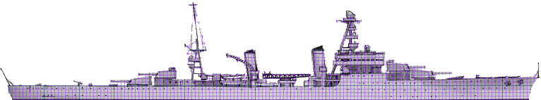

January 19, 20187 yr What i find a bit strange is that noone mentioned what would be my first step when doing anything in a scale: grab a few blueprints of the original (preferably a side-view and a top view), get a drawing program on your PC (I use paint.net), open the various images and draw aligned grids over them to determine the size in studs. Then, when you have that, you can start taking your bricks and "following the lines" on your grid so that the shape of your build matches the shape of the model. (Now I'm not a scale builder, but I sometimes use scale references like this for my Technic builds) You would get something like this: (I just picked any scale for example's sake). In my example, every grid cell is 1 by 1 stud, so this assuming studs-sideways building. if you want to build studs-up, or studs-forward (relative to the ship's orientation), then your grid changes, because bricks are not cubical but area actually cuboids whose height is 1.2 units (so a 1 x 1 brick is 1 x 1 x 1.2 units).
