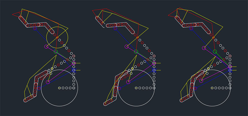

mpj Posted February 27, 2018 Posted February 27, 2018 This matter brings me back to 1 year ago, when I was facing the same with my Volvo Loader (in my case, the linkage is a little different than the standard Z-linkage). I worked a lot with autocad, but at the end the result was very good. Here is a preview. Quote
