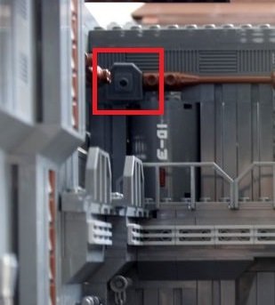

I was looking at some of the interior shots that Bricksmarlin shared, that showed some really nice customization work he had done.  There's one piece that I haven't seen before and I'm hoping someone might be able to identify the part # for me.  I out lined it in red below:
It's this part from the old Knights Kingdom action figures:
https://www.bricklink.com/v2/catalog/catalogitem.page?P=47474&idColor=86#T=C&C=86

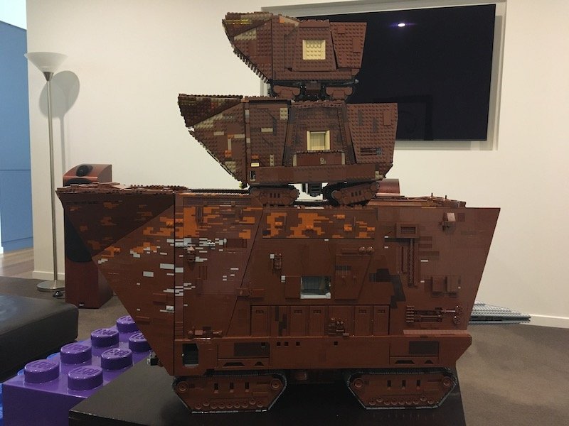

I recently finished this Sandcrawler and can attest to how amazing it is, and how enjoyable the build was.
There's a few minor issues with parts count and the instructions.  Handy to have spares to fall back upon, or be patient to order extras.  Overall, a very satisfying project.
Thank you to all involved in the design and instructions!
