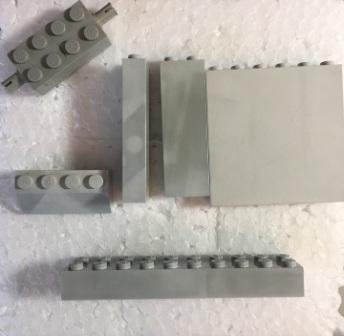

I have been brightening Legos for years now with Hydrogen Peroxide with good success.  I submerge the Lego pieces in a glass container with a glass sheet covering to keep the Legos under the solution top.  I started with 3 to 4 hours at first but over the years have found that a full two 8 hour days gets the best results.  I recently ran into a problem, though.  Using the same concentration (3%) hydrogen peroxide solution, same container, and same time length in the sun (2 days) I ended up with over "bleached" bricks.  I was working on an old gray (pre 2004) batch.  They are now mottled gray with very light gray patches and some are almost white.  Even weirder is that a small handful stayed the original old gray. Since the Lego is the same color all the way through I did not think this was possible.  I have heard/seen where an edge of a Lego brick that is not properly submerged will have a whiter demarcation for the bit above the liquid (I forget the technical term for this) but this happened to most of the pieces even those totally submerged.  Obviously, there are some Lego overlap patterns but I don't think that caused the bleaching.  I try not to crowd them but if they have overlapped/touched in the past the worst case was a spot where the yellowing was not removed and the Lego piece had to be redone.
As a chemist, can you think of a reason this happened?  Or, any way to reverse this.  I hate to throw away 1 lb of old gray parts as they are getting harder to come by.
Thanks,
kat-knapp
First, I will stress that this is all speculation on my part since I don't know what the dye used back then was, nor do I know what the flame retardants were.  That being said, there are a lot of possibilities:
• The sunlight is uneven.  Maybe shadows, the sunlight moving around in the sky, higher UV than usual, etc.  Use of a UV lamp would alleviate this problem or at least eliminate it as an issue.
• The unevenness almost looks like a pattern to me.  Either there was something covering it partially, or for part of the time, while it was undergoing reaction (and this would include air bubbles), or perhaps there was a coating of adhesive or something on the bricks that masked that portion
• Lego could have changed the dye and/or the flame retardant over the years.
• These bricks may have been treated previously, or been subjected to unknown temperatures or conditions.
If you're using the same brand of chemicals, it may be worth figuring out if the manufacturer has changed anything (doubtful).  If you use a plastic tub to clean in, UV light may be degrading that plastic and leaching out plasticizer or flame retardant from that container that mixes with the slurry you have up top and creates weird mottling or masking.
To me, the low res pic looks like the sun hit it unevenly.  That's a hard thing to change in solution, but you may be making thin films of the material between the bricks and the glass.  The light grey and white are probably the easiest to see it on.  I'm not sure that I have a lot of suggestions, other than using a glass tub, using a UV source, and making sure there's no overlap there.  It's not an easy thing to figure out, but that's what I would try first.  Good luck!

6 hours ago, kat-knapp said:
... can you think of a reason this happened?
I have seen the streaking with light gray as well. And I recall seeing images from someone else who noticed that the streaks were actually in the brick before the treatment, but the difference in colors was so subtle it was not noticeable under normal light.
So it may be that the chemicals causing the yellowing are not evenly distributed on the surface? Or not evenly mixed into the plastic?
I wonder if it also happens to white pieces but just is not noticeable because they are white?
Thank you @TeriXeri  @Grover @62Bricks   All of your responses were very helpful.  I am using only glass containers but I think it was just in the sun too long this time or rather too long in our Florida summer sun vs. the shorter cooler winter sun when I did it last.
I'll be more careful next time.  I'll keep these separate and see if they revert back after awhile and post if they do.
