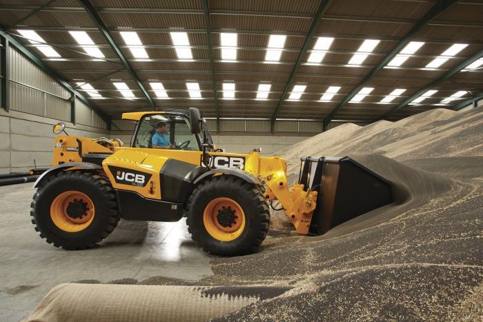

Since this year's flagship is (most likely) yellow, I'll continue with yellow MOC...
Propulsion with L-motor and servo for steering...
...tire announcement...
...with tires...
...and boom provisional placement...
Credits go to @eric trax for boom inspiration (only integrated m-motor will be used for attachments tilting), to @functionalTechnic whose beautiful JCB Loadall inspired me to start this project, and of course our telehandler lovers @grum64, @Maaboo35 ... and special MOC optimizer @jorgeopesi
