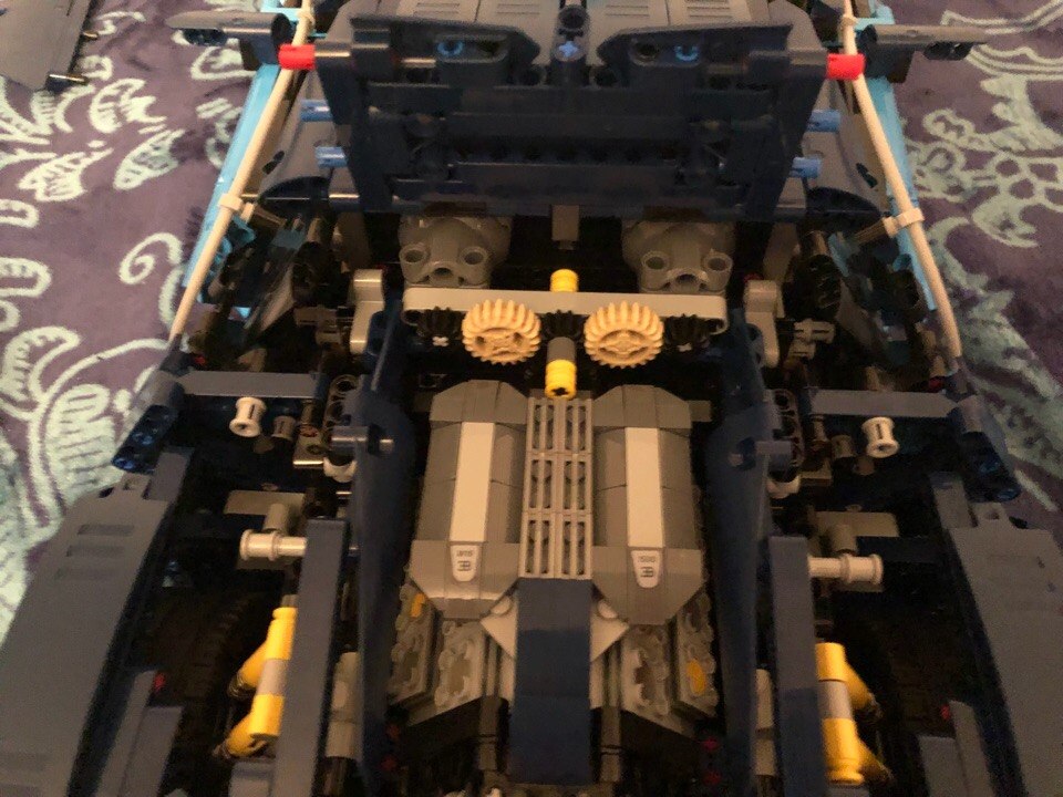

Esh Posted June 5, 2018 Posted June 5, 2018 Found a great spot for 2x L motors, next step is to disassemble most part of car to reach that white gear and change it with regular one. Quote
