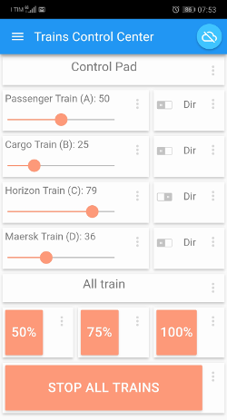

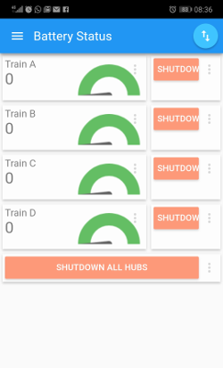

GianCann Posted February 2, 2019 Posted February 2, 2019 (edited) Thank you to the library written by @Mr Hobbles, i made a 'control train system' based on Raspberry 3B+ / MQTT / Node-Red. With this system it's possibile to control 4 trains at same time directly from smartphone phone with a free MQTT App Client. Raspberry act as Access Point for the smartphone device, and a bluetooth gateway for PoweredUp HUB. This is a first pieces of my 'ItLUG - Train System', a system to automate trains layout in a LEGO City Diorama with a complex logic. In each train there is a WiFi based sensor (realized with a ESP8266 03 chip) that track train position long the circuit. The Node-Red logic flow, interact with other device like railroad switch and level crossing barrier (also controlled by an ESP8266 device). I hope to make the Raspbian distro 'out of the box' available in a few days. This is the image of Node-Red Workflow (drive link to image, because it's to large to upload on Eurobricks Forum) These are the screenshots from Smartphone 'App' (it's based on IOT MQTT Panel App), one for control and one for battery status monitor Edited February 2, 2019 by GianCann Quote

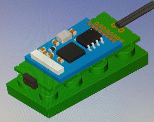

GianCann Posted February 4, 2019 Posted February 4, 2019 On 2/2/2019 at 4:00 PM, TrainDragon said: Can you share more info about this? Sounds neat. I am working, together with other AFOL, to develop various sensors (magnetic, proximity, laser) that enter the dimensions of a 2x4 brick and are powered to 9v. The sensors implement MQTT communication via WiFi. The Raspberry Pi 3B + system, with Node-Red and Mosquitto, functions as a message center and control logic between sensors and motors. This is the proxymity sensor based on Broacom ADPS9960 colors & proximity sensor. The ESP8266 chip act as WiFi client connected to an MQTT broker (running on Raspeberry) and send MQTT messages when the sensor is activated. Quote
Cosmik42 Posted February 4, 2019 Posted February 4, 2019 8 hours ago, GianCann said: I am working, together with other AFOL, to develop various sensors (magnetic, proximity, laser) that enter the dimensions of a 2x4 brick and are powered to 9v. The sensors implement MQTT communication via WiFi. The Raspberry Pi 3B + system, with Node-Red and Mosquitto, functions as a message center and control logic between sensors and motors. This is the proxymity sensor based on Broacom ADPS9960 colors & proximity sensor. The ESP8266 chip act as WiFi client connected to an MQTT broker (running on Raspeberry) and send MQTT messages when the sensor is activated. Sounds amazing! Do you plan to sell these? Any chance to make them compatible with PF or PF2 plugs? Would love to integrate these to "The Lego Train Project" if you make them available. Quote
