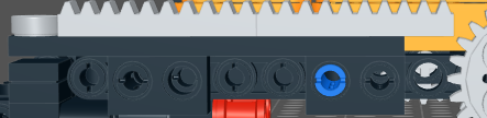

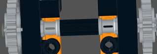

Jude The Lego Dude Posted June 11, 2023 Posted June 11, 2023 I reworked my old turntable and made a far more reliable version. Issues with the original; 1. The turning rig geometry didn't fit well with the banana gears which caused high friction and unreliability 2. the single layer or banana gears could split apart easily, causing the module to stop 3. the rotation relied heavily on gears sliding over tiles, not good 4. the whole thing was not in anyway symmetrical, which caused issues with train entry and exit. The new version addresses these issues. It features 2 turntables so that the mass of the train can easily be spread out and hold the train securely, entry and exit is smoother now. The whole thing is symmetrical, all half stud offsets have been addressed in the base of the module. Rubber band geometry has changed to boost reliability, the frame has been made a lot more rigid. I did 1 hr of testing with good results, train did not ever fail, I will do some more testing soon. @doug72 I can do some PDF instructions (should be a little bit better then the last ones) for you if you want to build it and have a look. https://bricksafe.com/pages/Jude_The_Lego_Dude/my-gbc-modules/turn-table Thanks Quote
