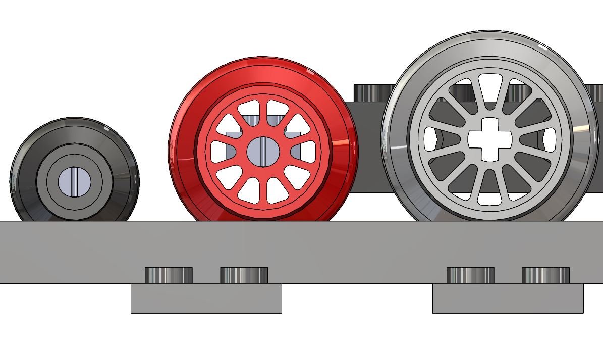

Working on a smaller wheel.  Not much room to provide for a technic axle hole.  Thinking about 14.4 mm in diameter (rolling diameter) with either a hole similar to 2927 or perhaps a metal axle.  Also considering both a solid and spoked variety.
Would appreciate any feedback.
Ben
Big Ben Bricks LLC
That's tricky, I would suggest staying away from the mounting style of 2927, those holes are higher friction and the wheels can pop off too easily.
My first thought would be a solid wheel with a technic axle hole, but even if you can get a technic axle hole in there when supported with normal technic bricks there would be little clearance to the track below. But it should work perfectly fine with technic beams or either of these:
After my bad experience with 2927 at a show, I've stayed away from all small wheels. But I could see this size being a good option for steam engine pilot trucks, smaller rail vehicles, etc.

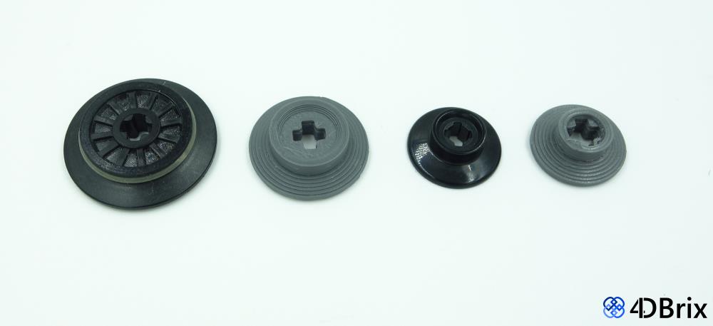

  I see 4DBrix has done this and is still offering them after the move to partner shops:
They are available from the partner sub-site Lowa's Brix, only listed in black, and have rubber rings.  I would still appreciate having an alternate source for these, and with a more thorough selection from a single source, as you offer.  And it would be great if the intermediate size fit the existing standard rubber band, as I mentioned above.  Accurate/smooth rotation is my biggest concern, especially considering how fast these would have to be rotating to get anywhere quick.

It's a tough one. I'd prefer a metal axle (as per the standard train wheel) or an X axle hole (powered, jackshaft locos here we come!). Using the road style connection point causes a lot of friction, and over time wear.
Agreed, I have just completed a train using those tram wheels and that pin connection is hopeless. It would be nice to have a fix for these wheels too, although Lego should really be doing this, those horrible things are preventing them from designing good tram models.
