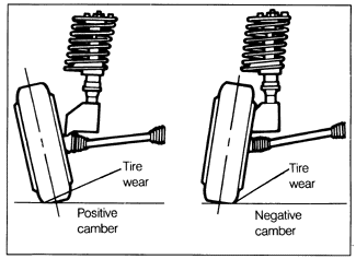

They are kind of soft, so rather grippy. A layer of clear tape or camber change would help.
