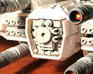

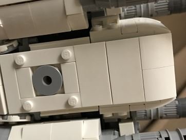

I've finally completed the model with a few modifications! Back in 2016 I had the goal of building the best LEGO X-Wing but studies got in the way before I could finish. Since then several amazing X-wing MOCs have come up culminating with Jerac's, which is my favourite in terms of the design and most importantly accuracy. So when someone pointed out earlier in the thread that the rear is one stud too short (which was acknowledged by Jerac), I just had to come up with a solution. Luckily it wasn't a difficult one.
Extending the rear by a stud also enabled the rear to be built much more robustly. The rear in the original design was about the most fragile part of the ship, and the pieces just didn't really come together that well. You almost have to squish the components together to get the desired look but it's clear the pieces do not fit in snugly. However with an additional stud length all the issues could be addressed, and the rear is now about as solid as the front of the ship.
Since the four side panels enclosing the rear now fit snugly in place, this created problems fitting the underside panel in its original form. I had to replace the 1x8 door rail piece with two 1x2 door rail pieces on each side of the underside panel for it to fit.

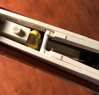

While I was building the ship, I noticed that I could put a flex tube here inside the front fuselage held together by the two clips already in the design. This allowed the sides of the fuselage to remain straight all the way down the length of the ship by pushing out the tiles against the panels underneath. I understand that ideally the sides should be straight without assistance, but practically it was difficult to achieve so the flex tube here really helped. On a separate note I'm not sure if it's "legal" to cut flex tubes into lengths that are not multiples of one stud.
And voila! I now have my perfect LEGO X-Wing thanks to Jerac. As you can probably tell I picked to build the white version, but I substituted all the reds for dark reds because I think it looks much more authentic that way, or maybe because I'm just too used to seeing that colour in official LEGO sets. I'd post a pic of the entire ship if I'm not limited by the 102KB attachment limit. Hope everyone else is as impressed as I am building Jerac's X-Wing.

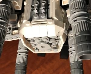

What internal changes did you make to extend the rear? Do you have any photos without the side panels on?
Here are some photos with the side panels and the back plate of greeblings removed.  As you can see the internal structure housing the gearbox is unchanged. I just replaced some plates with longer ones to extend the rear. The extra stud length then allowed me to attach the side panels using more parts, increasing the hold. As a personal preference, I try to avoid connections using a single stud because the attachment is just too weak in most cases.
I also pulled a dirty trick with a flex tube between two 1x1 open studs to keep the two 2x2 plates from collapsing inwards when pressure is applied from the outside.
This seems to be really nice mod. For sure it will strenghten the rear. I'd actually add another pair of hinges and perhaps think of a way to connecting bottom plating to the angled side sections somehow, but even without that it is an improvement.
