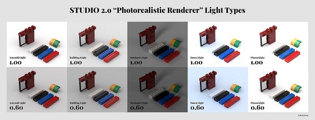

Posted September 19, 20186 yr The 2.0 version has a new rendering engine option, and it comes with some lighting presets that I've put together here. I've rendered these parts at full and 60% intensity. Light is coming from two sources via the front and left light source setting. Also, I have rendered the scene against a "floor" of a very light grey. My thoughts on each: Asteroid - makes for a good balance of brightness and contrast. The render is very "legible". Building - There's some light coming from above that illuminates the top faces of the bricks. This resulting sheen may be distracting, unless intentional. Mechanic - The dimness of this setting makes me wonder if it is best used where the background is simply transparent pixels. The light is a bit "harder". Notice the oblique shadows that have the potential to highlight surface details such as studs. Dawn - It is not likely that I will use this because of the bluing effect. Otherwise, the results are similar to Asteroid except for slightly more contrast. Notice that at full intensity the white brick is being lost to the background. Piazza - This is a blinding, high contrast setting. At full intensity the shadows nearly vanish, and definition is lost on lightly colored pieces such as white and medium orange, as I have used in the scene. Lessening the intensity brings back some definition, but at a cost to the color saturation. Notice how the blue and red pieces look less lively at 0.60. Conclusion: I have been using Studio for a year now, and it has become my main tool for Lego building. That these render options are more powerful than what is possible with POV-ray, yet are now just accessible by being bundled with Studio 2.0, makes me a very excited builder. Based on these tests I would recommend the Asteroid setting at an intensity between and .6 and 1 for most scenes. I would like to try the Mechanic setting against a transparent field for showing off things like technic assemblies where the goal of the illustration is showing off construction. The Building setting may suit illustrations emphasizing the overall form of a build. Edited September 19, 20186 yr by Plastic_Goth had more to say
