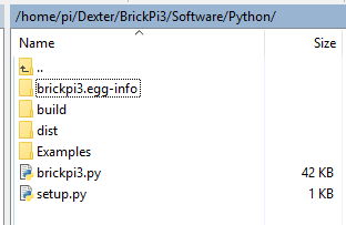

Jim Posted December 8, 2018 Author Posted December 8, 2018 I have cloned the repository to my Pi with this command: sudo git clone https://github.com/DexterInd/BrickPi3.git So now I have all the files on the Pi, but I think I need to install the Python modules somewhere. Quote
Jim Posted December 8, 2018 Author Posted December 8, 2018 I am not sure what I am doing, but I try to run the setup.py program. sudo python setup.py install Things are looking okay, but at the end I get an error: nstalled /usr/local/lib/python2.7/dist-packages/brickpi3-0.0.0-py2.7.egg Processing dependencies for brickpi3==0.0.0 Searching for spidev Reading https://pypi.python.org/simple/spidev/ Downloading https://files.pythonhosted.org/packages/36/83/73748b6e1819b57d8e1df8090200195cdae33aaa22a49a91ded16785eedd/spidev-3.2.tar.gz#sha256=09d2b5122f0dd79910713a11f9a0020f71537224bf829916def4fffc0ea59456 Best match: spidev 3.2 Processing spidev-3.2.tar.gz Writing /tmp/easy_install-7GLDQj/spidev-3.2/setup.cfg Running spidev-3.2/setup.py -q bdist_egg --dist-dir /tmp/easy_install-7GLDQj/spidev-3.2/egg-dist-tmp-Br6XdJ unable to execute 'arm-linux-gnueabihf-gcc': No such file or directory error: Setup script exited with error: command 'arm-linux-gnueabihf-gcc' failed with exit status 1 I am following the steps on this page, but I get the feeling that I am going in the wrong direction. https://github.com/ynsta/steamcontroller/issues/42 Quote
Jim Posted December 8, 2018 Author Posted December 8, 2018 I think I managed to install spidev, but somehow the brickpi3.py still doesn't see the spidev module. I think I see what the problem is. The module gets installed in Python2.7. I do have two version in the lib folder, Python 2.7 and Python 3.5. Quote
Jim Posted December 8, 2018 Author Posted December 8, 2018 This might do the trick: sudo python3 setup.py install I will continue to Rubber Duck here. The previous step indeed solved my spidev issue, resulting in a new issue. This is more or less the same issue as the spidev. Traceback (most recent call last): File "/home/robot/ev3dev-test/Examples/Test_Connected.py", line 16, in <module> import brickpi3 # import the BrickPi3 drivers File "build/bdist.linux-armv7l/egg/brickpi3.py", line 21, in <module> IOError: [Errno 2] No such file or directory ---------- Exited with error code 1. I have run the following command: sudo python3 setup.py install And I do see the following file in my user/local/lib/python3.5 folder: brickpi3-0.0.0-py3.5 Quote
Jim Posted December 8, 2018 Author Posted December 8, 2018 I do notice that all the ev3dev modules are located in python3 instead of python3.5. Maybe that is causing the issue. Quote
Jim Posted December 8, 2018 Author Posted December 8, 2018 Sigh....why do I still get this error: File "build/bdist.linux-armv7l/egg/brickpi3.py", line 21, in <module> IOError: [Errno 2] No such file or directory Installed /usr/local/lib/python3.5/dist-packages/brickpi3-0.0.0-py3.5.egg Processing dependencies for brickpi3==0.0.0 Searching for spidev==3.3 Best match: spidev 3.3 Adding spidev 3.3 to easy-install.pth file Using /usr/local/lib/python3.5/dist-packages Finished processing dependencies for brickpi3==0.0.0 running install_egg_info Copying brickpi3.egg-info to build/bdist.linux-armv7l/egg/brickpi3-0.0.0.egg-info I kinda understand the message. I copied the example files to my program, but I didn't include the build folder. So I somehow need to make sure that my program can find that build folder...or something like that?! Quote
Jim Posted December 8, 2018 Author Posted December 8, 2018 I have probably narrowed my issues down to this command: spi.open(0,1) This command doesn't work, but when I change it to: spi.open(0,0) ...it does work. The second number is the device id and apparently, I don't have a device with id 1. Another strange thing is that I when I run my program from VS Code, I get a permissions error. But when I use sudo python3 test.py from the terminal command line, it does work. Quote
