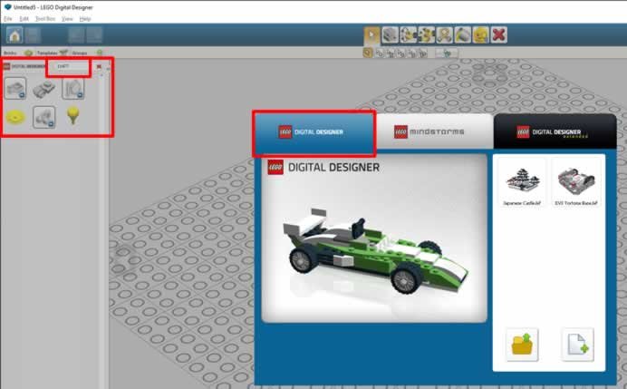

Hi all, I'm new to LDD but really enjoying it so far. I'm missing a few parts and can't find them anywhere is anyone able to help, I need 11477, 15068, 18976 & 18977. Any help would be greatly appreciated
I'm on the latest version 4.3.12 was the download although in the app it says 4.3.11
I've even tried installing older versions to see if they show but still no joy

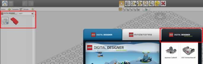

OK, I see. I have checked with 11477 which is not in the normal basic version, but is in the Extended version.
I cannot post better screenshots, but here is the normal version filter on part 11477 you see it is not there.
The second screenshot is the Extended version filter on 11477 so you see it is there.
Edited by Jaco
I guess that is heritage to the very beginning of LDD when you could model and order a design.
I think in the basic mode back then were bricks that were actually available to order.
In the extended version for instance you can make any brick any color I think. In theory you could not have ordered that design back then.
Now I think there are still only bricks in the basic mode there that actually exist in the available color.
