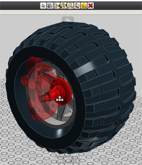

starflux30 Posted October 26, 2022 Posted October 26, 2022 There's an issue with the 92908 Gear Block attaching to the Power Puller tire/wheel assembly. It attaches without problem to the wheel without the tire, but not with it. There is no such problem with the real parts. Can it be fixed? Quote
jester Posted October 26, 2022 Posted October 26, 2022 12 hours ago, starflux30 said: There's an issue with the 92908 Gear Block attaching to the Power Puller tire/wheel assembly. It attaches without problem to the wheel without the tire, but not with it. There is no such problem with the real parts. Can it be fixed? Can you upload screenshot or parts number that doesn't attach? Quote

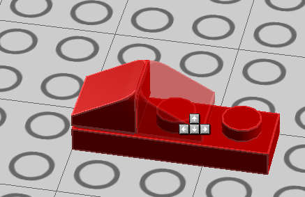

kiren_sun Posted October 27, 2022 Posted October 27, 2022 I can't put these two details side by side (54200). At the same time, similar parts with the prefix "transparent PC" (50746) are placed side by side normally. Quote
jester Posted October 27, 2022 Posted October 27, 2022 1 hour ago, SovetskiyMedved said: I can't put these two details side by side (54200). At the same time, similar parts with the prefix "transparent PC" (50746) are placed side by side normally. It had collision error Please download updated version here Quote
starflux30 Posted October 27, 2022 Posted October 27, 2022 22 hours ago, jester said: Can you upload screenshot or parts number that doesn't attach? Quote
jester Posted October 28, 2022 Posted October 28, 2022 8 hours ago, starflux30 said: I suppose it's an error with the tire, not gear blockю What parts did you use? Quote
starflux30 Posted October 28, 2022 Posted October 28, 2022 2 hours ago, jester said: I suppose it's an error with the tire, not gear blockю What parts did you use? I used these parts: 92908, 92909, 22969 and 32298 Quote
jester Posted October 28, 2022 Posted October 28, 2022 2 minutes ago, starflux30 said: I used these parts: 92908, 92909, 22969 and 32298 You can't attach it cause 32298 ( Tire) has incorrect collision data Quote
starflux30 Posted October 28, 2022 Posted October 28, 2022 1 minute ago, jester said: You can't attach it cause 32298 ( Tire) has incorrect collision data Is it fixable for the next update? :) Quote
kiren_sun Posted October 28, 2022 Posted October 28, 2022 14 hours ago, jester said: It had collision error Please download updated version here Thanks! :) Quote
Stephan Posted October 28, 2022 Posted October 28, 2022 7 hours ago, starflux30 said: Is it fixable for the next update? :) Yes, it is :) Quote
