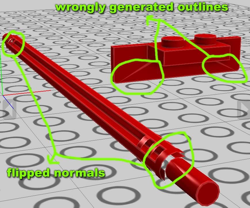

macouso Posted October 20, 2023 Posted October 20, 2023 (edited) Thanks for the reply! I know this prolly won't help anyone, just would like to say that at the moment I solved that g parts transition issue by creating one single mesh out of those g1, g2, g3 etc. brick sections (becoming one g1 part) and the "main" g brick is actually just some bottom part, so everything is basically one huge object thus smooth after all, haha (I know it's kind of lame but still works beautifully + of course that also means completely re-design UV mapping as well). As for the edge outlines: in some of new releases of LDD Brick Editor there will be new option to add your own edges outline mesh (we discussed this in Issues section on GitHub), so one can define himself exactly what he wants them to be + it will be much faster, actually immediate effect without waiting for that sometimes erroneous - sometimes, ehm in my case everytime not working at all - generation inside the app. 28802 is the brick ID of that custom brick of yours with wrong "strike-thru" outline (it is from the backside of the brick) - ignore that flex brick tho. :-) BTW can we ask for a bricks here too? If so, I would also like to see some of older bricks from 80s, like 2641 Edited October 21, 2023 by macouso Quote
