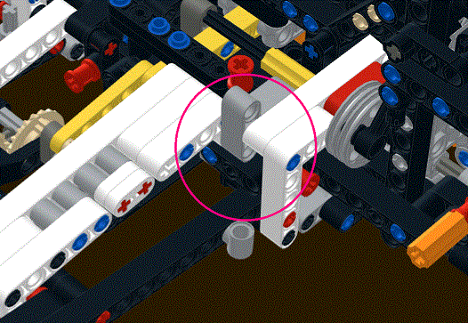

Swatch Posted October 1, 2023 Posted October 1, 2023 (edited) Got the wings on today... another bit of fussy assembling. But I do think I had a couple minor realizations around how Lipko did the center section that might better inform my build order. I do have a question for Nerdz or Lipko though... When I installed my wings, they are very floppy and I'm concerned I may be missing something. Is there supposed to be some sort of connection between the LtGrey T-shaped technic and the white wing panel? (see attached) To orient, that orange bit on the right is the propeller drive 'nipple' and the you're looking from the port/aft above toward the center section. Edited October 1, 2023 by Swatch Quote
Lipko Posted October 2, 2023 Author Posted October 2, 2023 8 hours ago, Swatch said: Got the wings on today... another bit of fussy assembling. But I do think I had a couple minor realizations around how Lipko did the center section that might better inform my build order. I do have a question for Nerdz or Lipko though... When I installed my wings, they are very floppy and I'm concerned I may be missing something. Is there supposed to be some sort of connection between the LtGrey T-shaped technic and the white wing panel? (see attached) To orient, that orange bit on the right is the propeller drive 'nipple' and the you're looking from the port/aft above toward the center section. There sshould be a 2L pin with bushing and a axle-pin connecting the T with the wing and the L beam at the same time. Quote
