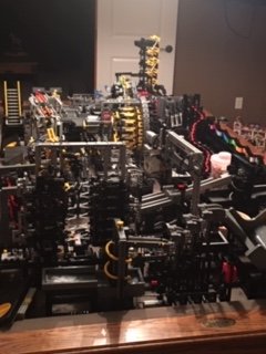

Ankoku Posted March 28, 2019 Posted March 28, 2019 All images I have from Akiyuki are posted earlier in this thread. There are only 2 sets. Here are the images I took the other night. https://bricksafe.com/pages/Ankoku/akiyuki-ball-factory-close-ups Surgery went well, but keeping it elevated all the time is a nightmare. I was thinking about the changes to the factory. The only bit which was pretty much correct was the wheel and wheel mover. Everything else required some fairly substantial changes. For me, the bit that still needs improving is the bucket unloading tower and Bob. I made quite a few changes to Bob (The bit which holds the bucket), which differ from Akiyuki, but there is still room for improvement or complete redesign. The rest I am happy with and are basically identical to the Akiyuki original. I am actually really happy with the slight reworking over the ball dropper, certainly doesn't drop balls and with the corrections to the tower, it is a far more positive movement anyhow. Fixing the tower made this part of the factory run super smoothly. Quote

Berthil Posted April 16, 2019 Author Posted April 16, 2019 (edited) Quick shot of current progress, 90% done. The whole factory is up about 8L. I try to keep an open structure as possible by reinforcing everywhere with liftarms. I had to make many modifications to fit everything. Every component I build first and then modify and fit into the structure. After fitting it gets tested extensively before continuing with the next component. The wheel can be removed easily and timing is also easier because of the open structure. I can lift it up at any corner without problems. MANY hours already went into this. At the moment waiting for 40t gears. Next are the last conveyor belts. Edited April 16, 2019 by Berthil Typos as always Quote

Berthil Posted April 19, 2019 Author Posted April 19, 2019 I have finished it and am very happy with it! It runs reliable on a 9V train supply with power selector on setting 4, 5 and 6 where 5 is equivalent to 1 ball per second. I've done a lot of mods to get it reliable. Most noticeable ones to bob (component that places the baskets back on the wheel) to prevent it throwing the basket out at high speed. With the in and out box lined up and at the correct height, it is now a fully GBC compliant module. I plan to make a video and photos this Easter weekend. Quote

Berthil Posted April 22, 2019 Author Posted April 22, 2019 (edited) So here it is, very pleased how it turned out and feeling confident to take it to events. Pictures will follow later. It runs comfortably on train power supply settings 4, 5 and 6 where 5 matches 1 ball per second. Edited April 22, 2019 by Berthil Quote
