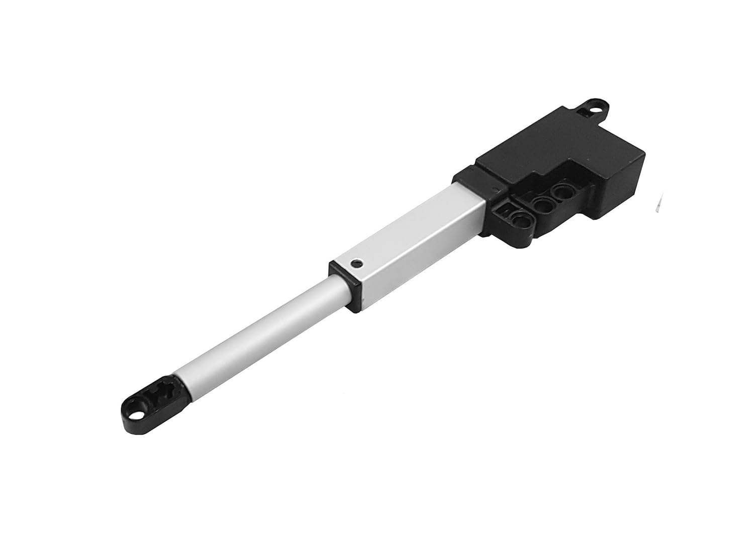

896gerard Posted June 19, 2019 Author Posted June 19, 2019 Regarding this debate, I have another question. (Still for the ultimate model I was talking about) I need a crane outtrigger with an extension of 100 millimetres, two studs wide and strong enough for a 2 kg model. The biggest concern to build this with Lego is that there are no gear racks long enough and small enough to fit within a two studs wide outtrigger. Lego Technic has seen this problem and come up with a part, but the extension is too small for my application. Also, the 18940 part requires an axle leading to the top of it for a powered extension. A a very visible axle does not help with getting a nice visually appealing scale model. Therefore, I decided to take up the gauntlet and start desiging this part for myself. The tried-and-tested prototype is below. This structure can support 10 kgs of weight (tested) and allows a very smooth extension of >100 mm. A big advantage of designing parts myself is that I can adjust the size anytime I want. And this is the time where I need some opinion on this. Is there a Technic way of doing this? Maybe I didn't think of something. I want to exhaust all options before using a non-Technic part inside a Technic model. Quote
powerwindows83 Posted July 8, 2019 Posted July 8, 2019 On 6/19/2019 at 6:06 AM, 896gerard said: Lego Technic has seen this problem and come up with a part, but the extension is too small for my application. Also, the 18940 part requires an axle leading to the top of it for a powered extension. A a very visible axle does not help with getting a nice visually appealing scale model. maybe if you put two in a row somehow? also if the axle itself isnt a design issue but the visibility of it is, could you cover the entire exposed length with red axle sleeves to cover everything but the worm gear(s)? just an attempt at keeping to vanilla lego Quote
896gerard Posted October 1, 2019 Author Posted October 1, 2019 I have done a lot of tests on the above outtriggers with linear actuators and the internal clutches kept engaging. Then I tried pneumatics and the air escaped from the hose fittings, while at the same time my tiny onboard compressor couldn't create enough pressure. The only solution: an entirely new linear actuator, fully developed in house, made to be fully compatible with Lego Technic electronics. This was a complete new experience for me and I learnt a lot in the process. The cilinder gets SLS printed and has full metal mechanics inside, much higher specced than the usual Lego Technic linear actuator. I'm excited about this new cilinder. Soon, the large actuators from the Lego 42100 Liebherr Excavator will be available. Cannot wait to setup a comparative test! Quote
agrof Posted October 1, 2019 Posted October 1, 2019 That looks really exciting project, any chance to take a look at the internals? Quote
Bartybum Posted October 3, 2019 Posted October 3, 2019 On 10/2/2019 at 1:27 AM, 896gerard said: I have done a lot of tests on the above outtriggers with linear actuators and the internal clutches kept engaging. Then I tried pneumatics and the air escaped from the hose fittings, while at the same time my tiny onboard compressor couldn't create enough pressure. The only solution: an entirely new linear actuator, fully developed in house, made to be fully compatible with Lego Technic electronics. This was a complete new experience for me and I learnt a lot in the process. The cilinder gets SLS printed and has full metal mechanics inside, much higher specced than the usual Lego Technic linear actuator. I'm excited about this new cilinder. Soon, the large actuators from the Lego 42100 Liebherr Excavator will be available. Cannot wait to setup a comparative test! *snip* Hold up, how do these extend if there's no axle opening at the back? Is there an electric motor inside? Quote
896gerard Posted October 3, 2019 Author Posted October 3, 2019 2 hours ago, Bartybum said: Hold up, how do these extend if there's no axle opening at the back? Is there an electric motor inside? You're right. A motor is placed inside the cilinder and also in the same tube, not placed in a box behind it. This gives a smooth finish and a Lego look which is not always achieved.. Quote
