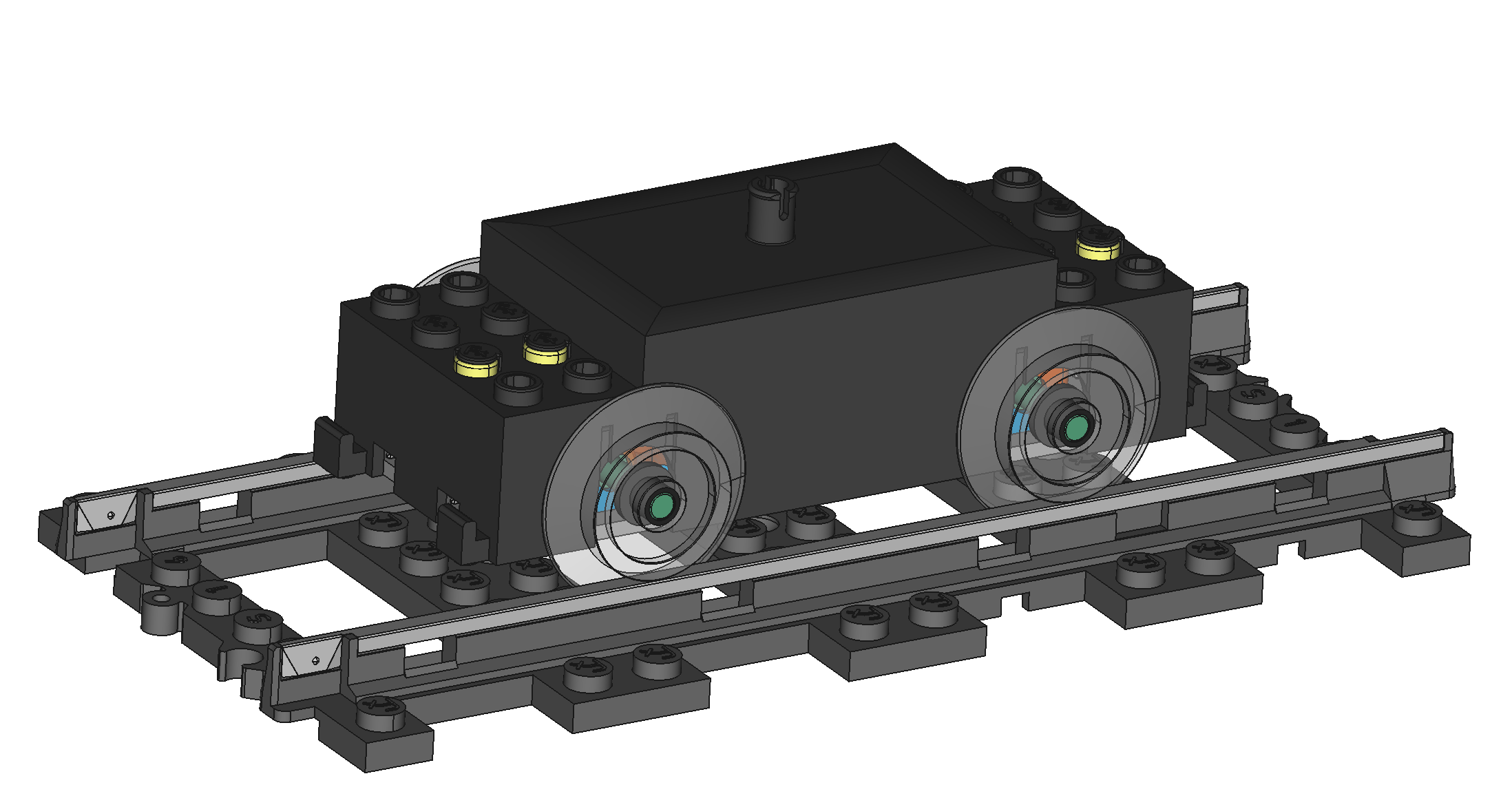

Might as well confirm the form factor with a teaser image! ...
p.s. the axles are not actually green on the final product!  :)
Are there any plans to make it so a train can run both PF/PU and 9V off a pick up? As tall an order as that is, it would be wonderful to have.
What a beauty!
Is there any room to put a pin hole in the middle for a fake wheel on a 3 axle truck? Perhaps with just a little vertical offset so that the motor with fake wheels can handle R40 curves (I'm not meaning to sound ungrateful as you resurrect what was thought to be an extinct species, rather, with all of the other improvements you are making just suggesting additional QOL changes in case they might be easy to include). In any event, I THINK the lego motor sides require a small indent somewhere between the wheels.
