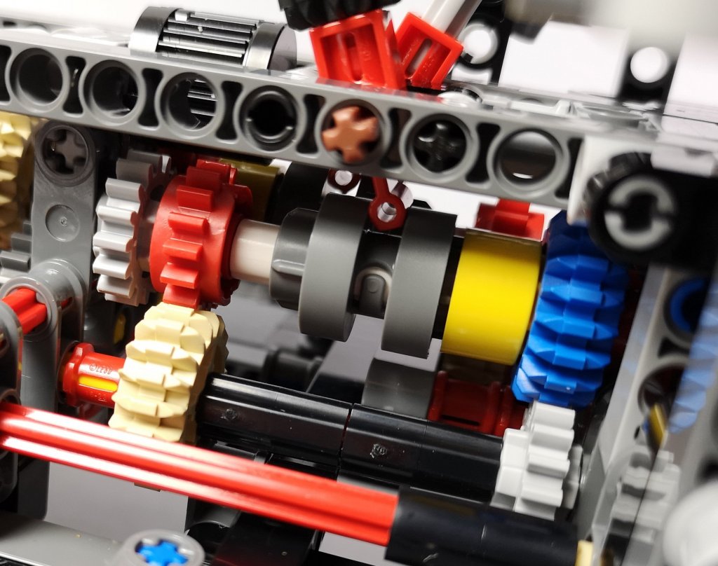

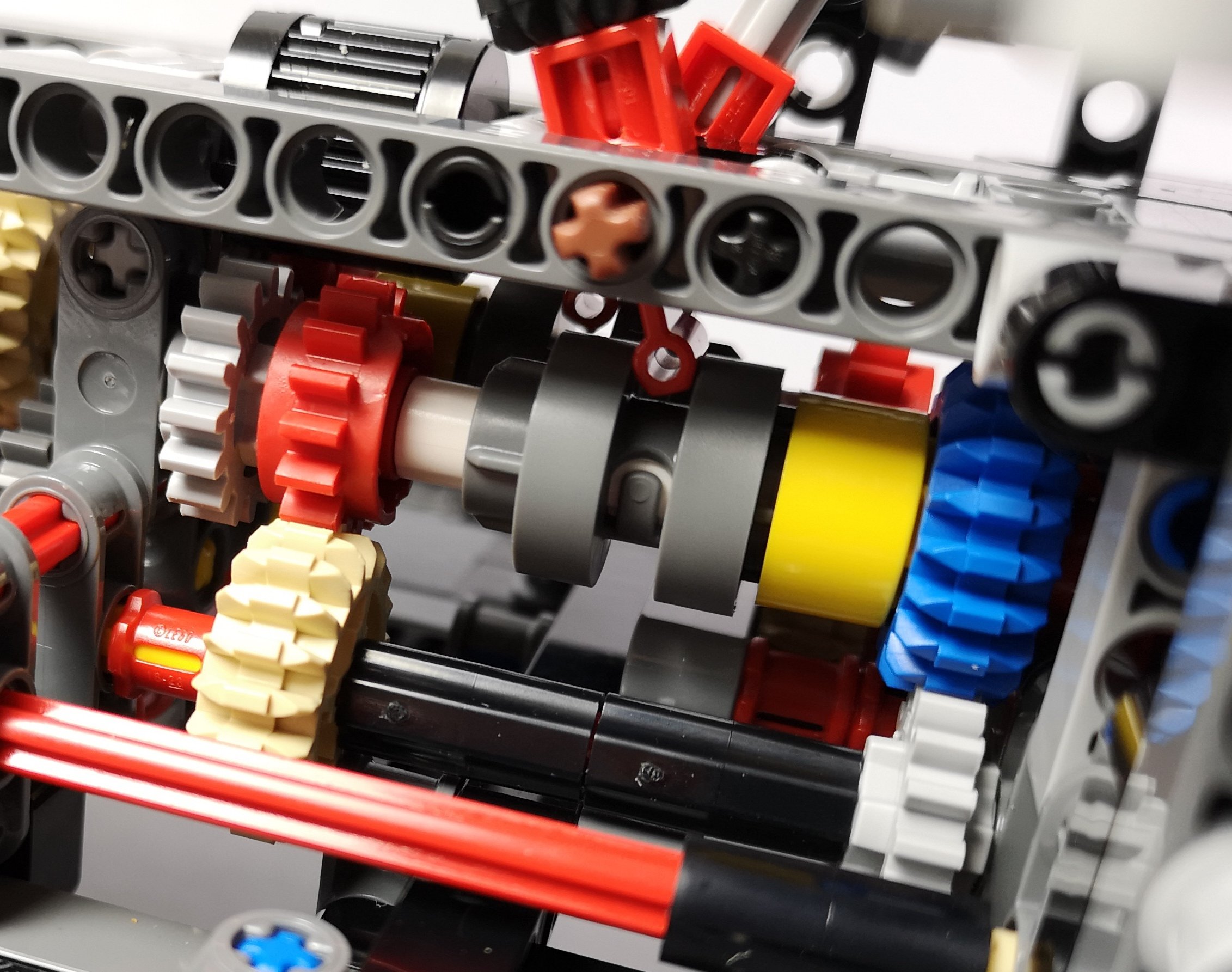

@Anio Nice analysis - you would be correct, except for the current sticker. I’ve taken a few screenshots from @kbalage’s video that should explain, as they include the hi-lo sticker:
In other words, your analysis is right, but the hi-lo sticker is wrong.
Indeed !
I actually never apply the stickers. Didn't see that hi-lo sticker was printed that way.
To me it is obvious that when lever is push at the rear, it makes a multiplication (from the wheels towards the engine), and so it is Low gear.
So, to sum it up, @kbalage you were right : both stickers are wrong. At least from a true mechanical perspective.

So here's my quick fix:
1. turn the + - sticker upside down
2. remove the Hi / Lo sticker, cut it in half, apply the parts swapped
3. proper shifting sequence :)

Copy that. But would it be possible for the Hi Lo to switch the red and tan with the blue and grey gear?
That would be an option.
But it makes the "slow mode" with lever at the front, while it would make more sense if pushed toward the rear.
You can't switch them easily, there's not enough space for the blue clutch gear if you'd like to swap it with the red one. The yellow extension ring is right next to the red clutch gear.
14 hours ago, BrickWild said:
Building it on Stud.io following Sariel's speed build that I 'slowed down' on Adobe Premier, filling in the wait for the building guide to go online. ;-)
Good Job!
Oh would that black sequential selector be in the way of the blue gear if you wanted to swap the red and blue clutches?
Yes, that'd be also a problem, so there're more reasons why the clutch gears cannot be swapped. Rearranging the gear selector and this whole middle section might be a solution, but flipping the stickers is actually still easier :)
