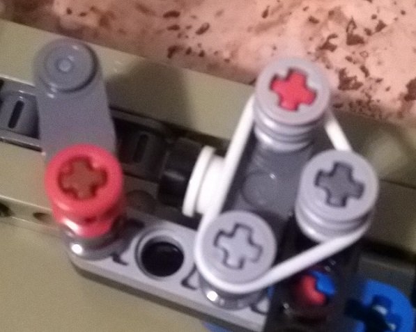

Enantiomeer Posted October 5, 2019 Posted October 5, 2019 I noticed that the elastic rubber band which is used to keep the back door latch in the locked position is quite slack: Should be an easy fix by replacing the red bush 3713 bush with a small wheel rim (11208 or 55982 or 56903) with a slightly bigger diameter to pick up the slack. Quote

Polarlicht Posted October 5, 2019 Posted October 5, 2019 1 hour ago, Enantiomeer said: I noticed that the elastic rubber band which is used to keep the back door latch in the locked position is quite slack: Should be an easy fix by replacing the red bush 3713 bush with a small wheel rim (11208 or 55982 or 56903) with a slightly bigger diameter to pick up the slack. I just did this, repositioned some parts Quote
Enantiomeer Posted October 5, 2019 Posted October 5, 2019 9 minutes ago, Coolusername said: I just did this, repositioned some parts Very nice, even simpler solution. Just tried it and it works like a charm. Thanks! Quote
Polarlicht Posted October 5, 2019 Posted October 5, 2019 Yeah i used an extra 1/2 bushing from spare parts, but you don't even need to, just take one from the red 2l axle ;) Quote

Arioh Posted October 13, 2019 Posted October 13, 2019 Finally finished build of my copy of this awesome set... ... as RHD variant. To do such version i mirrmirrored assembly of bags for 1 and 2 stages of the build. Stages 3 and 4 built as normal. Also i found easy fix for tailgate loose rubber band - I guess that Grohl made it being loose on purpose - to lock door by simple pushing it. I tried both fixes - Sariel's and Coolusername's - they both made rear lock to work really tight. Too tight for my taste. So i replaced red bush with old micromotor pulley. Bigger pulley part didnt lets band to slip off, and in same time keeping it relaxed as original variant. Quote
