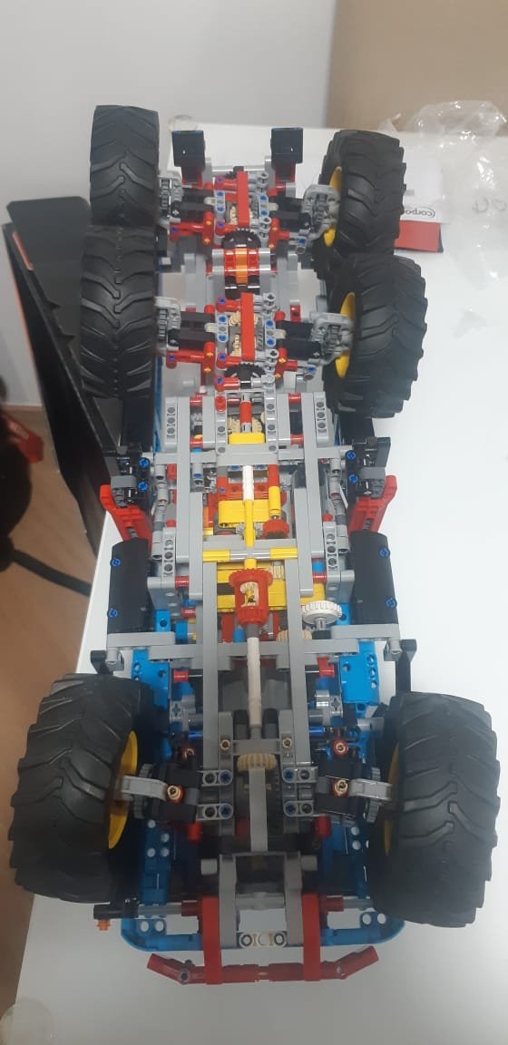

thiagovieira Posted August 28, 2019 Posted August 28, 2019 Hello guys, How are you? Im new here, Im from Brazil and Im mounting my 4th Lego toy, I finished and everything is mounted by the book, is doing all movements except go backwards and forwards. Looks like that I dont have enough traction to move truck. Im attaching photo from bottom, as im new here i dont if is possible to upload a video, but i will try. thank you so much guys for your attention, as this is my new complex lego, maybe lost a detail. Quote
Zerobricks Posted August 28, 2019 Posted August 28, 2019 Your second axle's diff needs to be flipped. I think we need a 42070 help topic pinned, as by so many people having issues with this set's driveline. Quote
thiagovieira Posted August 28, 2019 Author Posted August 28, 2019 Hello Zerobricks, Thank you so much for your help, but as im starting can i kindly ask you to circle part that needs to inverted please? Quote
thiagovieira Posted August 28, 2019 Author Posted August 28, 2019 Hello JunkstyleGio, How are you? Thank you so much, i didnt know that could influence on that.. :( I will try to do it today or tomorrow, when i got some time and post result here. once again, thank you so much. Quote
JunkstyleGio Posted August 28, 2019 Posted August 28, 2019 @thiagovieira Don't worry it is one of the most common mistakse made with this model. Quote
Henkl Posted August 28, 2019 Posted August 28, 2019 The second axl would drive forward and the third axl backwards at the same time. That's wy its not moving. Quote

thiagovieira Posted August 28, 2019 Author Posted August 28, 2019 ahahha, im just afraid to exchange axle position, looks like a hard job. Quote
Maaboo the Witch Posted August 28, 2019 Posted August 28, 2019 13 minutes ago, thiagovieira said: ahahha, im just afraid to exchange axle position, looks like a hard job. Remove the bodywork and modular build sections. This way you have less to take apart and rebuild. Quote
thiagovieira Posted August 28, 2019 Author Posted August 28, 2019 Hey guys, I just rotate 180 degrees second drive. I really loved ,it's working now. Unfortunately I can't post here. Someone knows how to explain that effect in engineering words? Once again thank you so much. Quote
Mechbuilds Posted August 29, 2019 Posted August 29, 2019 8 hours ago, thiagovieira said: Hey guys, I just rotate 180 degrees second drive. I really loved ,it's working now. Unfortunately I can't post here. Someone knows how to explain that effect in engineering words? Once again thank you so much. When a gear is turning, the second gear it's turning will turn in an opposite direction. So look at the gears and think: "Left, right, left, right, left, right.." Quote
