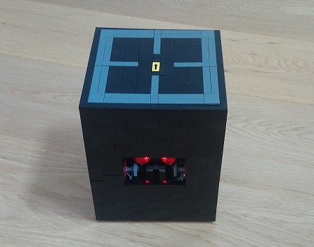

I would like to share with you my latest achievement, a maze solver. The maze is 4m² and has 100 boxes of 18cm x 18 cm. The robot has 4 ultrasonic detectors to analyse each case and mecanum wheels driven by 4 vertical engines.
The whole is controlled by an EV3 brick hidden inside.
You can follow the robot’s path on a second EV3 brick by bluetooth as well as its analysis which may lead to prohibit certain boxes.
The robot measures 15cm x 15 cm and it is therefore difficult to move accurately in the labyrinth without hitting the walls. That was one of the difficulties, but I wanted it to be aesthetic and therefore with a body.
When the robot arrives in a cell, it analyzes the 4 faces. If it sees 3 walls it blacklists the cell. If there are 2 walls and a forbidden cell next to it, it also blacklists the cell. At each cell it updates an array data of 100 datas, 1 per cell. In this array we will find all the informations about the path of the robot. In case of iddentic choice the robot randomly chooses its direction.

Thank you very much. This is true for the remark I could not have stopped in every cell, but I had problems with the mecanum wheels and their drift; it was easier to redo a RAZ every time. The problem is there’s not much room between the robot and the wall. Probably spending a lot of time I would have managed to do it, but the most interesting was the maze resolution algorithm and the transmission to the other EV3. Thank you for your encouraging comments.

I have a question, at 1:00 minute in the video your robot marks the entry square as forbidden, why? It has a forbidden block next to it, but only 1 wall (not 2).
Because of that it also marks the next 2 blocks as forbidden, but those two blocks including the entry block are part of the solution...

No it does not use this algorithm, it gradually condemns the boxes and makes random choices when there are several possibilities. And he never returns to a condemned box. He eventually finds the way out, it goes faster on average than the hand to the left or to the right.

his is the starting point, he knows that entry is a forbidden exit and so it is like a wall. It is normal that he condemns the cell.

He’s gonna go back and go through all the open cells... and when he does all that, it’s gonna be the big bug. I didn’t handle the situation, I could have blown it up.
