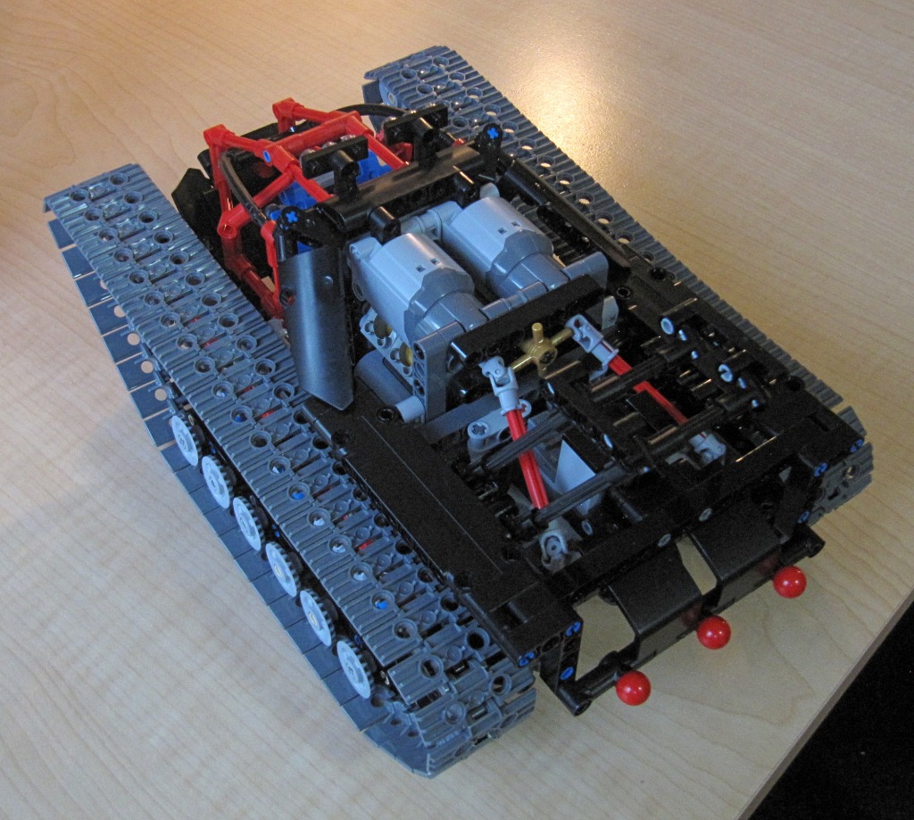

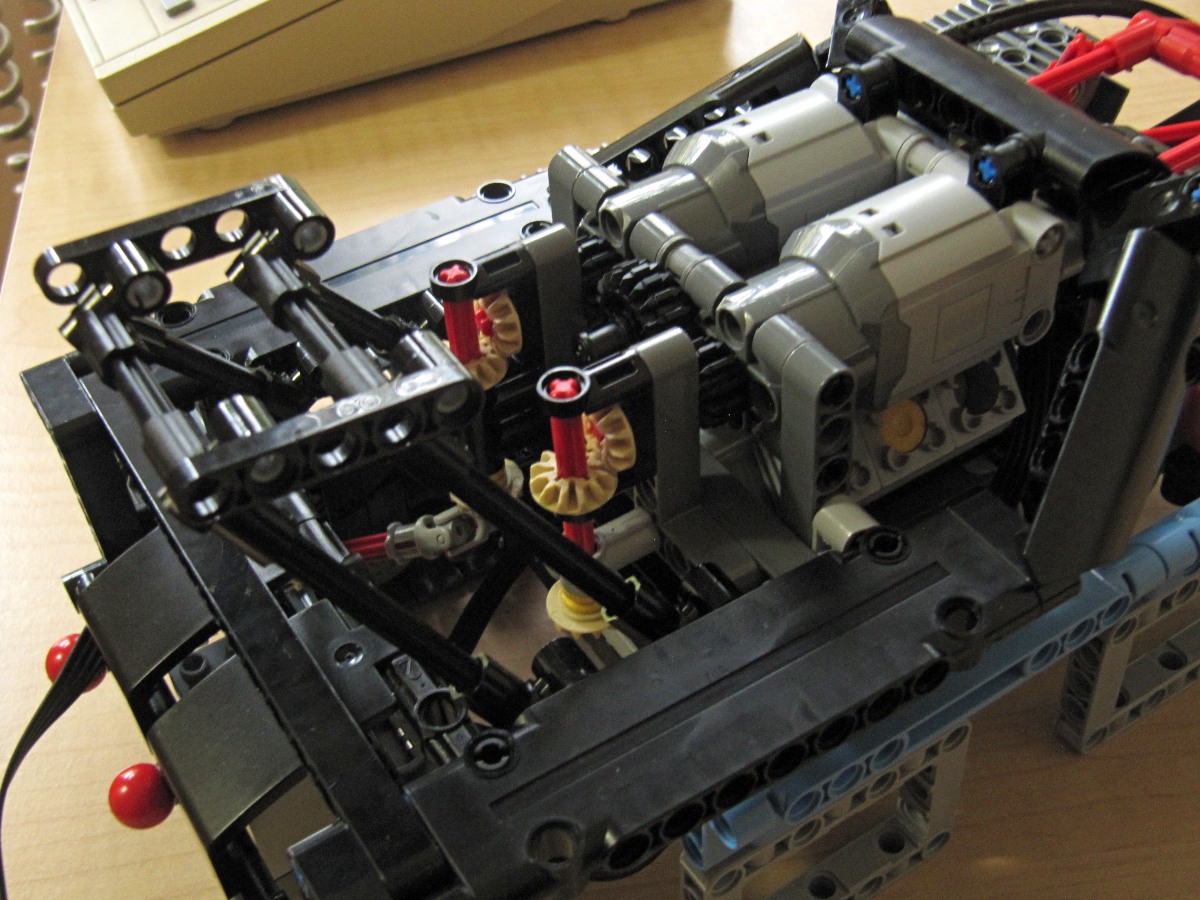

ozacek Posted October 21, 2019 Author Posted October 21, 2019 Actually I think I found a solution that solves all problems: it keeps the motors up, the U-joints angles below 45, removes the hard-coupling but still allows to drive the fake engine (via a differential). Quote
ozacek Posted October 21, 2019 Author Posted October 21, 2019 Here's what it looks like once attached to the frame. Quote
ozacek Posted October 22, 2019 Author Posted October 22, 2019 I finished the design, and I will now go on with the tedious task of making instructions for it. I'm happy that I could keep the build very modular - all these modules more or less just clip to each other: Quote

ozacek Posted October 27, 2019 Author Posted October 27, 2019 It turns out the traction doesn't work after all, the powering axles invariably pop out of their socket after a few seconds. It looks like I can't use small 12T bevel gears after... some serious redesign will be needed. Quote

ozacek Posted October 27, 2019 Author Posted October 27, 2019 (edited) This time it's complete, tested & working. Instructions are ~80% complete. Edited October 27, 2019 by ozacek Quote

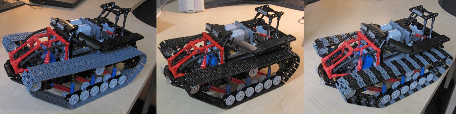

ozacek Posted October 28, 2019 Author Posted October 28, 2019 Does it look better with black tracks? I find the front part does, but then the rear is black-over-black... Quote
johnnym Posted October 28, 2019 Posted October 28, 2019 On 10/27/2019 at 1:53 PM, ozacek said: That's a simple solution I didn't think about! However I already redesigned it, and it's actually much better, everything around the moving parts now holds much stronger. EDIT: ah but wait, there's a reason I didn't think about that: you can' insert a 3L axle pin stop with the stop inside the black axle holder part.. Ok, I thought if it doesn't break it would be allowed It's some fiddling, but it "works". But still better that you found an alternative to bending parts. 19 hours ago, ozacek said: This time it's complete, tested & working. Instructions are ~80% complete. Nice one, especially the side profile of the tracks - it captures the look of the real tracks very well I think. 12 hours ago, ozacek said: Does it look better with black tracks? I find the front part does, but then the rear is black-over-black... Well, I can't really tell. The gray tracks add a little more contrast to it. The black tracks might be closer to reality. Ever tried black and gray alternating? Might look strange, but I could imagine that it will create some interesting effect when driving. Quote
ozacek Posted October 28, 2019 Author Posted October 28, 2019 (edited) 5 hours ago, johnnym said: Ok, I thought if it doesn't break it would be allowed It's some fiddling, but it "works". Ohh I see what you mean. No, I don't do that :) If there's something I learned by designing Technics, it's that there's always a solution, no matter how hard it looks. 5 hours ago, johnnym said: Ever tried black and gray alternating? Might look strange, but I could imagine that it will create some interesting effect when driving. Exactly my thinking :) I tried that yesterday, it looks good, but I still can't quite make up my mind. What do you think? @others: an opinion maybe? For comparision: Edited October 28, 2019 by ozacek Quote
johnnym Posted October 28, 2019 Posted October 28, 2019 3 minutes ago, ozacek said: Ohh I see what you mean. No, I don't do that :) If there's something I learned by designing Technics, it's that there's always a solution, no matter how hard it looks. You're right, but I'm more of a "do it right later if it works good enough now" guy. There comes a problem with that: most of my models are WIP constantly. 3 minutes ago, ozacek said: Exactly my thinking :) I tried that yesterday, it's nice, and I'm tempted to go with that, but I still can't quite make up my mind. What do you think? It reminds me of something, but I can't say what... ....or wait, yeah, the Cheshire Cat from Alice's Adventures in Wonderland It looks interesting and different - I'd keep it for the uniqueness alone. And looking back at the other two versions, I'd stay with this one, it's more attractive. Quote
andythenorth Posted October 28, 2019 Posted October 28, 2019 (edited) The angle on the u-joints near the sprockets looks brutal, but does it run well? Edited October 28, 2019 by andythenorth Quote
ozacek Posted October 28, 2019 Author Posted October 28, 2019 21 minutes ago, andythenorth said: The angle on the u-joints near the sprockets looks brutal, but does it run well? You're right, it is very near the limit, and because of that their rotation isn't completely smooth. But there's no effect I can see when the vehicle runs (although power is most likely lost because of that). When you let in run in the air, you can feel it's a bit 'stacato'. It reminds a bit of the bursts of combustion engine pistsons - it's actually not a bad effect :) Quote
